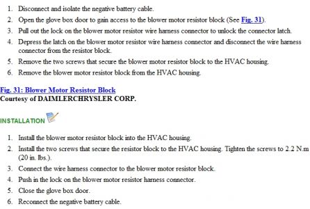

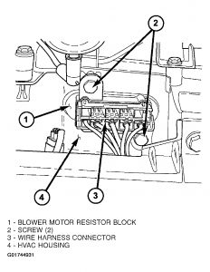

How do you replace the blower motor resistor I'm told its very simple that it is located right under or behind the glove box
Saturday, April 17th, 2010 AT 11:22 AM
