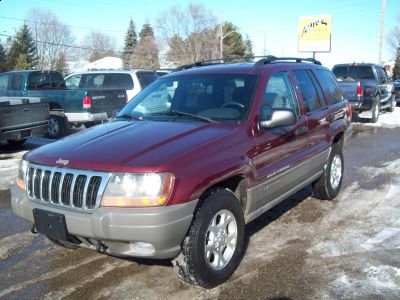

I have no gauges and the 2000 jeep laredo wont turn over. it wants to start but it is like it have no feul but it has feul in the lines any ideas
http://www.2carpros.com/forum/automotive_pictures/398354_9368l23_20_1.jpg

Hello, nice looking vehicle. If your saying it cranks good but won't start, have a helper crank it, while you check for spark at the plugs and injector pulse. With the gage issue, I might check the feed to and from the ignition switch. The battery has a full charge and battery connections are all clean and tight on the ends?
