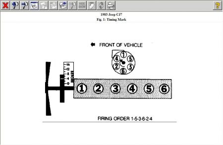

Firing order for 258 6 cylinder
ISLANDANDERSON
MEMBER
1983 JEEP CJ7
6 CYL
4WD
MANUAL
200,000 MILES
What is firing order for 6 cylinder 258?
Wednesday, April 16th, 2008 AT 9:25 AM
MECHANIC
75,992 POSTS
+49
Wednesday, April 16th, 2008 AT 9:44 AM
