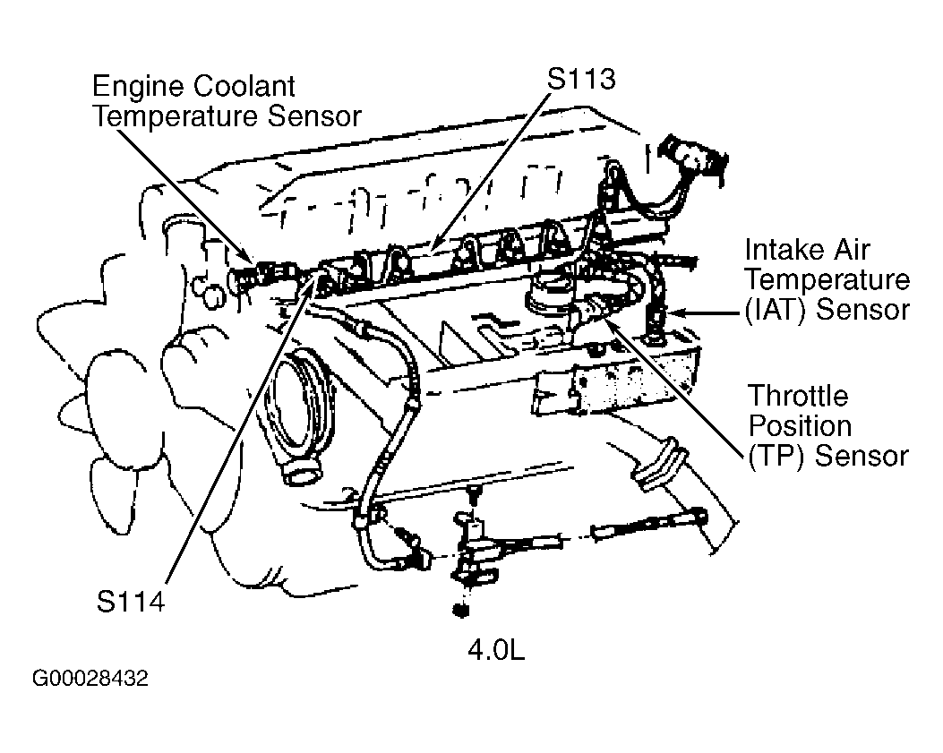

1999 jeep Cherokee 4.0. Doesn't idle when you start it. Have to feather gas pedal. When you take it out of neutral and drive, it idles and drives fine happens whenever you start jeep
Friday, May 3rd, 2019 AT 1:58 PM (Merged)
  • 75,992 POSTS
Check and test the idle air control valve, EGR valve and throttle position sensor
JULIUS187
Idle control valve is it located on the throttle body. Throttle position sensor where is that located
  • 75,992 POSTS
Throttle Position (TP) Sensor (4.0L)On throttle body assembly.
