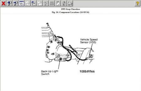

SPEEDOMETER DOESNT WORK, IT IS READING 180MPH IN A SITTING OR DRIVING POSITION, IS THE SPEED SENSOR BAD OR POSSIBLY THE PINION GEAR BAD?
Monday, July 13th, 2020 AT 10:54 AM (Merged)
  • 75,992 POSTS
Inspect and test the vehicle speed sensor its at the transmission extension housing
https://www.2carpros.com/forum/automotive_pictures/12900_vss_22.jpg

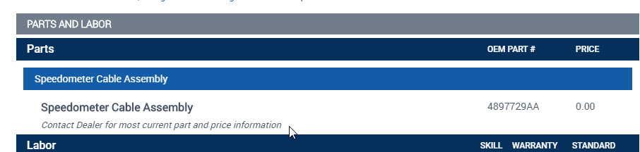

My speedometer cable bounces so I took it out and lubed it with graphite with no luck the bouncing is still there. I've tried to re lube it with several different lubes with no luck. I don't understand what is the problem?
Monday, July 13th, 2020 AT 11:01 AM (Merged)
MHPAUTOS
  • 31,937 POSTS
HI there,
Thank you for the donation,
Due to the length of the cable there may be a bit of stretch in the inner drive cable and it is skipping off the outer cable, on other cars with this problem I have never had any luck trying to lube them, all they do is bind up more, the lube tends to bet to sticky and causes the inner to bind a bit, I feel the only option is a new cable.
Mark (mhpautos)
GREENCHEVYMALIBU
  • 230 POSTS
Thanks i'll change it and get back to you with the outcome. Which cable should I replace. There is a real short one that connects to the cluster then to what looks like a sensor then from the other end the long cable bolts to it and to the transmission.
MHPAUTOS
  • 31,937 POSTS
Hi there,
I would be replacing both cables.
Mark (mhpautos)
GREENCHEVYMALIBU
  • 230 POSTS
Do you know where I can get both. AutoZone sells universal cables but I don't think they have the little cable.
