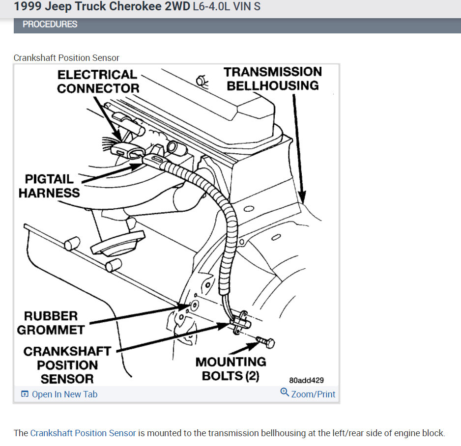

I need to replace the crankshaft sensor can you help me?
Thursday, April 16th, 2009 AT 9:02 PM
18 Replies
BLUELIGHTNIN6
  • 16,542 POSTS
Here is the location of the crankshaft sensor which is in the bellhousing of the transmission. Check out the diagrams (Below). Please let us know what happens.

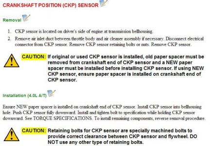

HOW TO SET AIR GAP ON CRANK SENOR
Monday, December 7th, 2020 AT 9:36 AM (Merged)
BLUELIGHTNIN6
  • 16,542 POSTS
New sensor should come with paper spacer that slides into end
ALPHILHOWER
I, M REPLACING TRANS USINGOLD CRANK SENSOR BECAUSE IT'S NOT THAT OLD; NEED TO KNOW AIR GAP. THANK S FOR YOUR HELP.
BLUELIGHTNIN6
  • 16,542 POSTS
Is your CKP sensor attached with 2 bolts or just 1? If it is 2 then you just install it with those same 2 bolts and the gap will be correct
ALPHILHOWER
MY 98 JEEP HAS ONLY ONE BOLT.
BLUELIGHTNIN6
  • 16,542 POSTS
Ok the paper spacer is the Air Gap it has no numerical value so if the old sensor is missing the paper you will need a new one

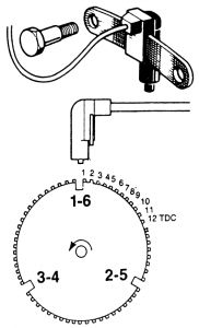

https://www.2carpros.com/forum/automotive_pictures/52960_0900c152800a9b06_1.jpg
The Crankshaft Position Sensor (CKP) is secured by special shouldered bolts to the flywheel/drive plate housing. It is preset in its mounting at the factory and is non-adjustable in the field. The sensor senses TDC and engine speed by detecting the flywheel teeth as they pass during engine operation.
The flywheel has a large trigger tooth and notch located 12 small teeth before each Top Dead Center (TDC) position. When a small tooth and notch pass the magnet core in the sensor, the concentration and then collapse of the magnetic flux induces a small voltage spike into the sensor pickup coil winding. These small voltage spikes enable the ECU to count the teeth as they pass the sensor.
When a large trigger tooth and notch pass the magnet core in the sensor, the increased concentration/collapse of the magnetic flux induces a higher voltage spike into the pickup coil winding. This higher voltage spike indicates to the ECU that a piston will soon be at the TDC position 12 teeth later. The ignition timing for the cylinder is either advanced or retarded as necessary by the ECU according to the sensor inputs.

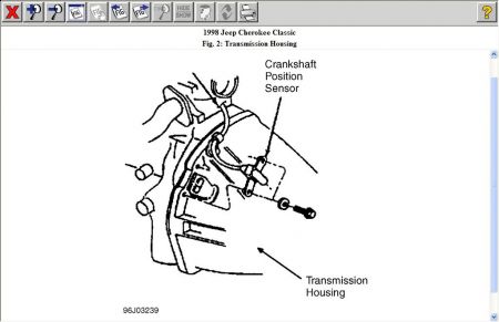

I need some advice on changing the CKP sensor. I tried taking off the shift cable bracket, then used an 11mm wrench and an 11mm socket. I can get the bottom bolt out but the higher one is the problem. Is there any tips or specific tools I could use. I am going to buy a swivel socket and try that next. If there are any tricks out there I would really appreciate it. Thank You
BLUELIGHTNIN6
  • 16,542 POSTS
Depends on type of Cherokee, below are replacement steps for the Jeep Cherokee Classic
https://www.2carpros.com/forum/automotive_pictures/261618_Noname_1691.jpg
https://www.2carpros.com/forum/automotive_pictures/261618_Noname2_534.jpg

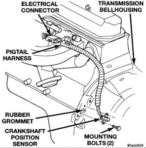

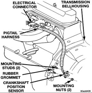

Could you please tell me steps required to replace the crankshaft position sensor in the 1998 Jeep? Does the tranny have to be dropped a little to do this?
Monday, December 7th, 2020 AT 9:37 AM (Merged)
  • 75,992 POSTS
Service and Repair
https://www.2carpros.com/forum/automotive_pictures/12900_c1_43.jpg
https://www.2carpros.com/forum/automotive_pictures/12900_c2_35.jpg
The crankshaft position sensor is mounted to the transmission bellhousing at the left/rear side of engine block.
This engines have the sensor attached with two bolts.
REMOVAL
Some model/engine combinations may require removal of air cleaner tubes for access to sensor.
Remove air cleaner tube(s) at throttle body (if necessary).
Near rear of intake manifold, disconnect pigtail harness (electrical connector) from main electrical harness.
Depending upon application, remove either sensor mounting bolts or nuts.
Remove sensor.
INSTALLATION

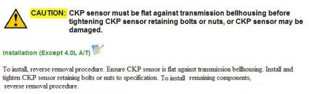

Install sensor flush against opening in transmission housing.
2.5L engines equipped with automatic transmission: Install and tighten two sensor mounting nuts to 19 N.m (14 ft. lbs.) torque.
Install and tighten two sensor mounting bolts to 19 N.m (14 ft. lbs.) torque. The two sensor mounting bolts are specially machined to correctly space unit to flywheel. Do not attempt to install any other bolts.
