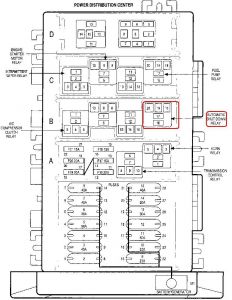

ZACKMAN
  • 4,202 POSTS
ASD relay is inside the Power Distribution Center (Fuse/Relay Box) under the hood.
https://www.2carpros.com/forum/automotive_pictures/55316_98gcpdc_1.jpg
https://www.2carpros.com/forum/automotive_pictures/55316_98gcpdc_2.jpg

I replaced the asd and so foar everything is running fine but the jeep cut out after I replaced the asd just a little but everthing is fine so far

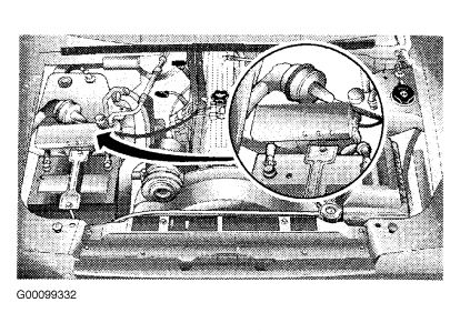

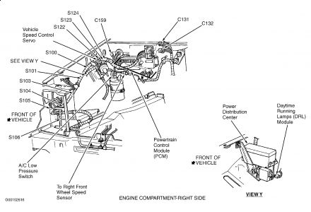

Where is the computer that and how do I change the crankshaft position senor and this code has pop up 3 times could it be a bad ignition coil senor and map senor
Tuesday, March 3rd, 2009 AT 11:24 PM
ZACKMAN
  • 4,202 POSTS
As you have replaced the coil and MAP sensor, I really think that it is the wiring to those parts. You have to make sure that the connectors are tight and there is no frayed wire. Connections at the part and also at the computer.
PCM is at the rear right of engine compartment, near the AC receiver-drier.
https://www.2carpros.com/forum/automotive_pictures/55316_98gcpcm_1.jpg
CKP sensor is in the transmission bellhousing.

LOSTONE32
  • 16 POSTS
It was the connection to the computer that was loose and the part will be in on friday I hope this works and I will give you a tip friday
