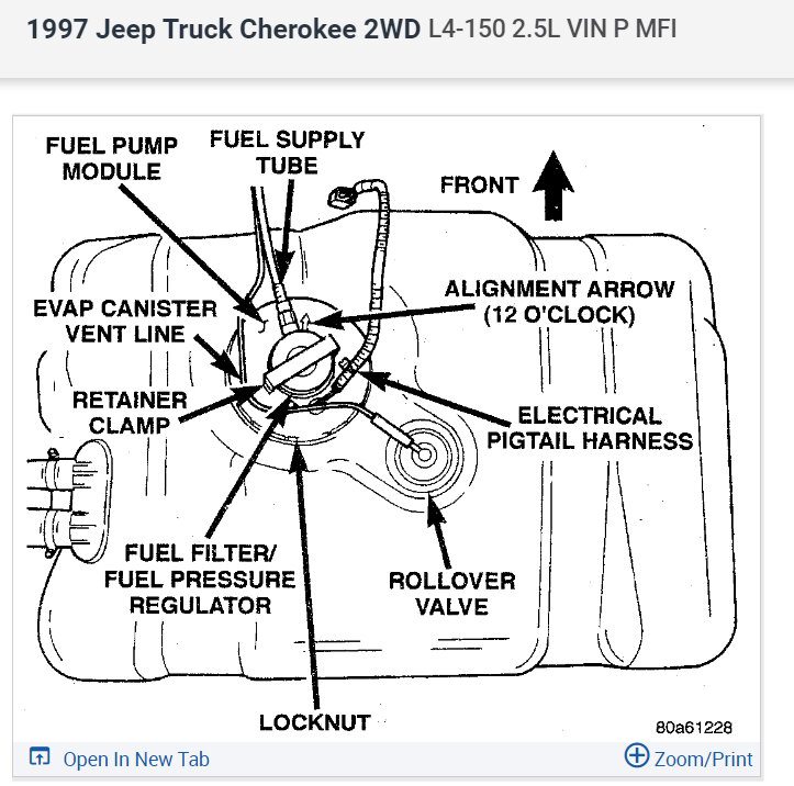

1997 Jeep Cherokee location of fuel filters
DONNY YORK
  • 1997 JEEP CHEROKEE
Other Category problem
1997 Jeep Cherokee Engine Size unknown Four Wheel Drive Automatic 194000 miles
where are they located?
Sunday, December 2nd, 2007 AT 9:51 PM
2 Replies

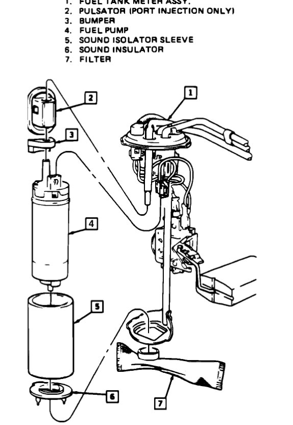

BLACKOP555
  • 10,386 POSTS
There is one located in the tank on the fuel pump, and there is one located after the pump and before the engine. Follow the fuel lines to find it.
Sunday, December 2nd, 2007 AT 10:02 PM
KEN L
  • MASTER CERTIFIED MECHANIC
  • 55,130 POSTS
Nope, there is only one fuel filter which is on top of the fuel tank, here is the fuel fitler location and how to change it out.

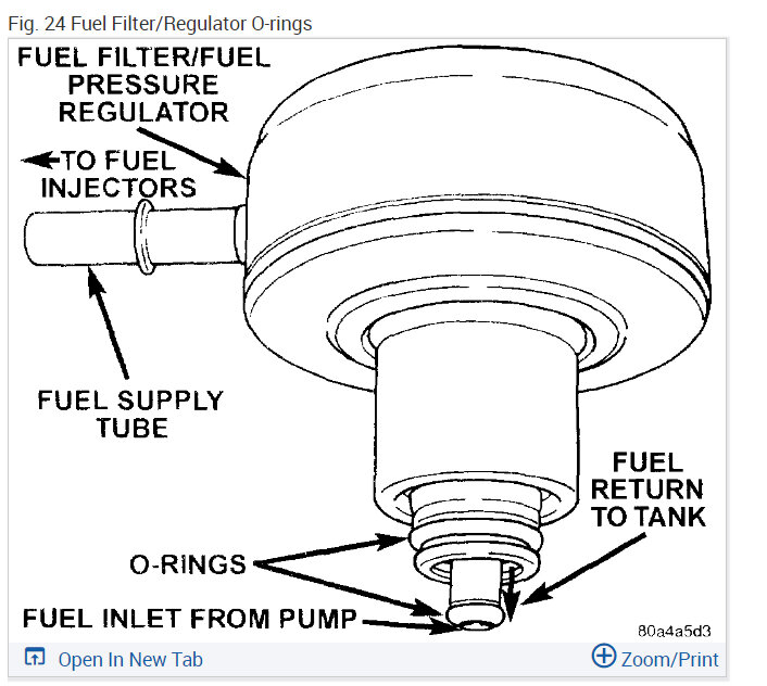

Fig. 21 Fuel Filter/Regulator O-Rings
7. Before discarding filter/regulator assembly inspect assembly to verify that 0-rings (Fig. 21) are intact. If the smallest of the two 0-rings can not be found on bottom of filter/regulator it may be necessary to remove it from the fuel inlet passage in fuel pump module.

Check out the images (below). Let us know if you need anything else.
