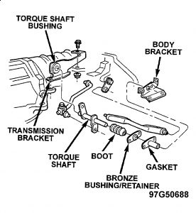

Hi I have a 1996 Jeep Grand Cherokee Laredo, 5.2 liter V8, with quadra trac all wheel drive. So heres whats happening: Whenever I take off from a stop, such as a light for instance I get a intermitent popping that seems to be coming from somewhere underneath, sometimes is sound like its from the front end, sometimes the middle or the rear. Also whenever I turn left and accelerate, such as I left turn at a light, I get kind of a grand/pop that is coming from the left front end, only happens when turning left and sometimes I can feel the pop/grind through the floor. Also if I am accelerating and hit bumps under the front end I also get a pop. What I have had done so far: I have had the left front axle replaced, and the lower left ball joints replaced. I have also had my sway bar inlinks and bushings replaced, and the left front wheel bearing, and still get the noise! If you have any ideas as to what is stressing me out please feel free to let me know. THANKS!
