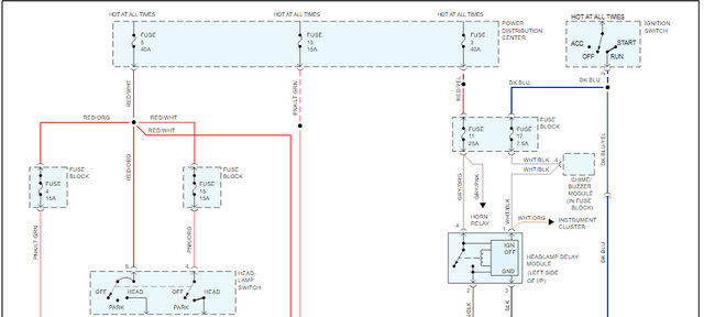

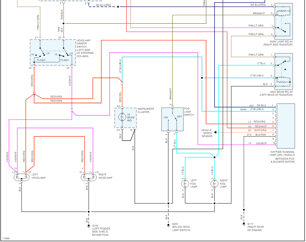

Lights worked fine for a year, parked the car and turned off the lights, few hours later I came out and only the high beams worked (if I held the lever back), fixed that issue by replacing the entire light toggle/switch behind the dash. The new problem is that pulled all the way back only my headlights work, no dash lights and more dangerous, no tail lights. As of now i'm driving with hazards. Complete opposite works if the switch is barely pulled out (dash and tail lights function, but no headlights). I've replaced twice, one new and one junkyarded. Also checked the fuses, all are good. Any ideas?

It sounds like the issue is with the wiring harness for the switch.
It has likely have loose or partially corroded connection that attached to the switch. That's why you can manipulate the switch to make one work and not the other.
Inspect the connectors for any corrosion or burnt pin(s).
https://www.2carpros.com/articles/how-a-headlight-switch-works
I have included the wiring schematics for your reference.
