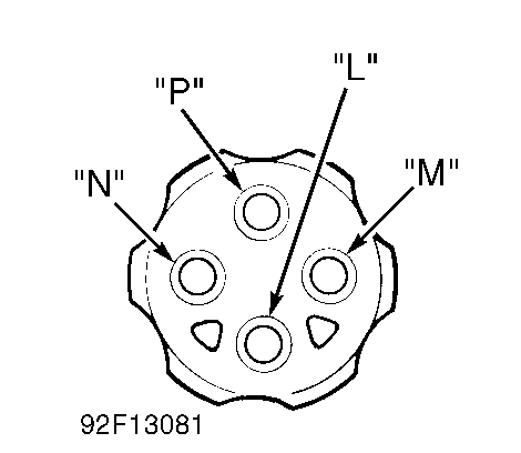

It has a lever next to the gear shifter. It goes 2H, 4H, N, 4L. The rest of the time it stays in 2H, and when I switch it to 4H a bad grinding sound comes from the front axle area when I start to accelerate.

Ok what need to be done now is check the vacuum switch. Now on the transfer case there is a vacuum switch with 4 vacuum hoses connected to it. Now use the pic below to do the following test. In 2wd use a vacuum pump to get 15 inches of vacuum to L. Now you should have vacuum to M. Now switch to 4x4 and apply vacuum to L and you should have vacuum to N. If any of this fails then the switch is bad. Let me know what you find and we will check the front differectial actuator next.

"I have a 91 jeep Cherokee, and the four wheel drive is not working. I believe it is the actuator in the front axel. I have vacume to the actuator. Is there suppose to be vacume on both lines going to the actuator? I currently do not have that. The frotn drive axel turns but the front wheels will not engage.

Shift to 2WD position. Locate vacuum switch on front of transfer case. Apply 15 in. Hg vacuum to "L". See Fig. 1. Vacuum should be present at "M". Connect a vacuum gauge to "N". Shift to 4WD position. Apply
vacuum to "L". Vacuum should be present at "N". If switch fails any test,  replace switch. Pic included
