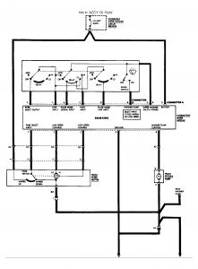

After replacing (what I thought was a bad motor) front windshield wiper motor still have no wipers. I've tested all wires running to wiring harness and everything reads "hot" Tested new motor with a jump of a battery pack and good to go. Tested all circuit breakers/fuses all read positive.
My question is? Do I know crack open stearing column and see if the switch is engaging?

WINDSHIELD WIPERS CHEROKEE, COMANCHE & WAGONEER 1. POWER INPUT Remove circuit breaker. Test battery side of circuit breaker. If battery voltage is not present, repair open to splice. Test across circuit breaker terminals. Tester reading should be zero (0) ohms. If not, replace circuit breaker. 2. GROUND Connector A unplugged. Test terminal G. Tester reading should be zero (0) ohms. If not, repair open to ground. 3. INTERMITTENT WIPERS Ignition switch in ACCY. Remove delay module and plug connectors together from the module. If wiper operate in LO and HI speed modes and mist (washer) is working, if wipers and mist operate, replace intermittent module. If not go to step 4. 4. WIPER/WASHER SWITCH Ignition in RUN, wiper switch position as indicated, back probe switch side of connector A for standard, connector B for intermittent: Test connector terminal E-wiper switch in LO and mist/intermittent. If battery voltage is not present, replace switch. test connector terminal C-wiper switch in HI. If battery voltage is not present, replace switch. Test connector terminal F-wiper switch to OFF. If battery voltage is present until wipers stop and then voltage drops to zero (0), system is working fine. If this does not occur, replace switch. 5. INTERMITTENT WIPERS Connector B unplug. Test across terminal A and D while rotating switch from minimum to maximum delay. If tester reading is not between 0-500 ohms, replace switch. Test across terminal A and G while rotating switch from minimum delay to maximum delay. If tester reading is between 0 and 500 ohms, replace wiper module. If not replace switch. 6. WIPER MOTOR Ignition in ACCY, wiper switch position as indicated, probe connector D. Test connector terminal 1. If resistance is no zero (0) ohms,repair open to ground. Test connector terminal 4-wiper switch in any position. If battery voltage is present, replace motor. if is not repair open from fuse panel. Test connector terminal 2-wiper switch in LO. If battery voltage is present, replace motor. If not , repair open from wiper switch. Test connector terminal 2-wiper switch in HI. If battery voltage is present, replace motor. If not , repair open from wiper switch. Test connector terminal 5-wiper switch OFF with voltmeter connected. If battery voltage is present until wipers stop and then voltage drops to zero, system is OK, replace motor. If not, repair open from wiper switch.
https://www.2carpros.com/forum/automotive_pictures/62217_jeep1_1.jpg
https://www.2carpros.com/forum/automotive_pictures/62217_jeep2_1.jpg
