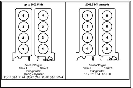

I would appreciate if someone would tell me which cylinder is # 8.
Thursday, October 14th, 2010 AT 6:29 PM
MECHANIC
75,992 POSTS
Check sparkplug,compression and fuel injector on #8 cylinder.
The following Jaguar image depicts two firing orders that are defined differently but are actually the same order.
