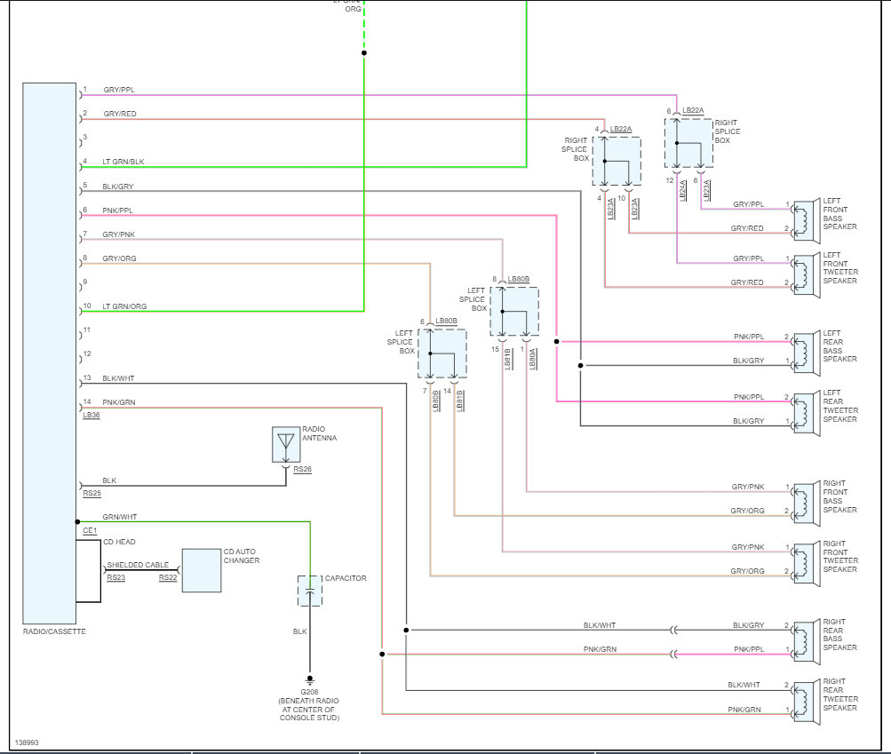

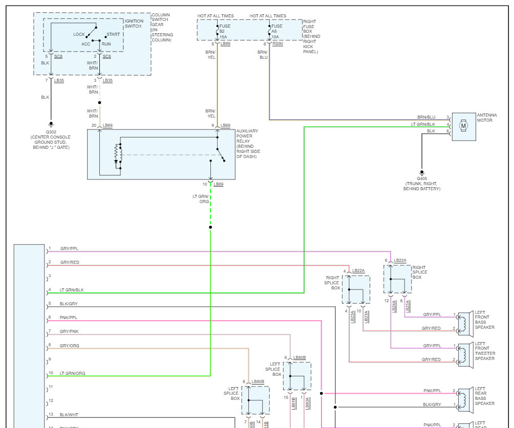

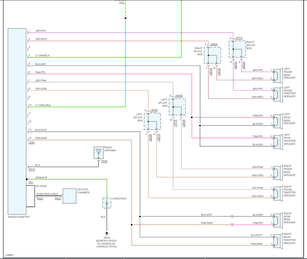

Radio will not come on, will not light up nor will the antena go up. Check fuse, ok.
Saturday, July 19th, 2008 AT 4:10 PM
JAMES W.
  • 2,394 POSTS
There are 3 fuses that control radio function. 2 are in the right hand fuse panel. One feeds the auxiliary relay (under the dash,passenger side with a yellow socket. Other feeds the antenna motor. The third is in the LH fuse panel and feeds the radio itself. All 3 of these circuits pass through the radio. If the 3 fuses and the relay are good, then it is something in your radio. Here is a guide to help you test for power and ground and the radio wiring diagrams so you can see how the system works and which wires to test.
Check out the images (Below). Please let us know how it goes
