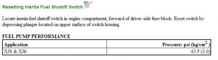

JAMES W.
  • 2,394 POSTS
There should be a pressure tap on the fuel rail for checking pressure. You'll need to get a gauge that will attach to thios tap. If everything is normal, you should get a pressure reading of 43.5 lbs with key on, or on engine crank.
https://www.2carpros.com/forum/automotive_pictures/248092_93_XJ6_1.jpg
