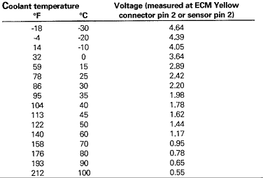

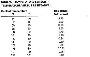

Hello, we hope this helps.
COOLANT TEMPERATURE SENSOR AND CIRCUIT - DTC 14
The ECM looks for the coolant temperature sensor signal voltage out of range.
The coolant temperature sensor is a negative temperature coefficient sensor; the higher the temperature, the lower the resistance. The sensor is located on top of the thermostat housing
https://www.2carpros.com/forum/automotive_pictures/248015_1_4.gif
https://www.2carpros.com/forum/automotive_pictures/248015_2_4.gif

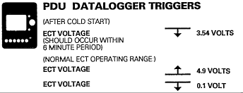

The coolant temperature signal voltage can be monitored and intermittent faults captured using the PDU "Datalogger" function.
https://www.2carpros.com/forum/automotive_pictures/248015_3_4.gif

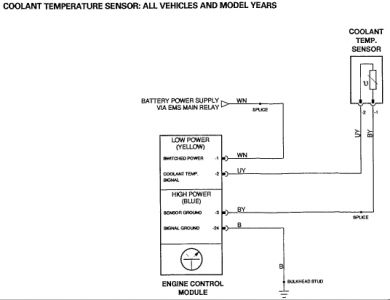

Circuit Diagram
https://www.2carpros.com/forum/automotive_pictures/248015_4_1.jpg

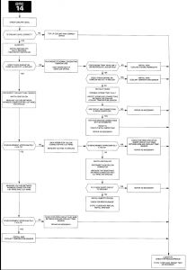

Flow Chart: DTC 14
https://www.2carpros.com/forum/automotive_pictures/248015_5_1.jpg
