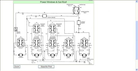

Where does the power come from to power the center console wireing harnes? The windows and sun roof do not have power. Thanks doug

It gets its power from the ignition switch thru the power window relay-test this relay or swap or replace it and see what happens
