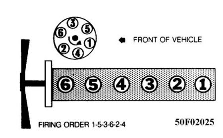

Plugged cat? Or something else common with these cars? It has Bosch FI.
Also anyone have correct firing order and placement on the cap for wires.

https://www.2carpros.com/forum/automotive_pictures/12900_fo_117.jpg
