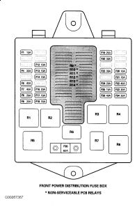

My wiper motor is not getting power which relay controls this and what fuses can I check I found 3 fus boxes are there more?
Monday, May 18th, 2009 AT 5:33 PM
DAVE H
MECHANIC
13,384 POSTS
Wiper Fast/Slow Relay (R8)In front power distribution fuse box. See Fig. 1 .
Wiper On/Off Relay (R4)In front power distribution fuse box.
