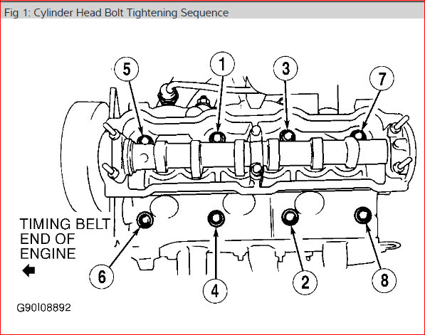

I have attached a picture of the tightening sequence. The head bolts are to be torqued to 54 FT LBS. Hope this helps and please feel free to ask any questions if needed. Danny-
Jul 3, 2018 at 3:16 PM

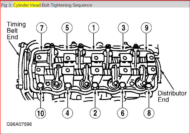

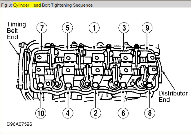

My Geo metro is a four cylinder 1.3L with ten bolts can you give me the sequence for this engine? Thanks
Jul 3, 2018 at 5:16 PM
DANNY L
  • 5,648 POSTS
Hello again, Danny here.
Sorry about that. Here is the correct picture. Again, these are to be torqued to 54 FT LBS. Thanks again for using 2CarPros!
