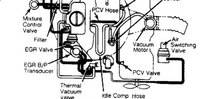

I got all my vac. hoses fixed except the ones on top of the carb. theres 5 fittings on top , all plugged off for some reason what does each fitting go to, except the big one, i know it goes to the charcoal canister, and the fuel line that leaves 3 im stumped on, any advice will be greatly appreciated
http://www.2carpros.com/forum/automotive_pictures/448830_carb_3.jpg
carb # is 8941367610 if it helps

Hi there,
Not 100% sure if this is yours, let me know if its not.
Mark (mhpautos)
https://www.2carpros.com/forum/automotive_pictures/61395_isuzu_1.jpg

Hi there, here are the 4 variants of the 2.3 engine that i can find, see how this goes.
Mark
https://www.2carpros.com/forum/automotive_pictures/61395_Graphic1_13.jpg
https://www.2carpros.com/forum/automotive_pictures/61395_Graphic2_6.jpg
https://www.2carpros.com/forum/automotive_pictures/61395_Graphic3_3.jpg
https://www.2carpros.com/forum/automotive_pictures/61395_Graphic4_1.jpg

Hi mark, one of the diagrams you sent me has to be it but there are so many hoses colored black that run together I cant tell where they go. Could you please send me a more clearer picture of those 4 diagrams. Thanks for helping me out. This is my only means of transportation

Hi there,
If I try and blow them up they go very fuzzy, what I will do is try and do 1 in 2 or 3 parts, now is yours a cal or Federal and is it a trooper or a pick up? Sorry about the questions as I am in Australia we call them different names here an I want to get his right.

Hey mark, I done some research, mine is a federal
Sunday, December 20th, 2009 AT 10:15 PM
MHPAUTOS
  • 31,937 POSTS
How is this.
https://www.2carpros.com/forum/automotive_pictures/61395_carby2_1.jpg
https://www.2carpros.com/forum/automotive_pictures/61395_carby1_1.jpg
