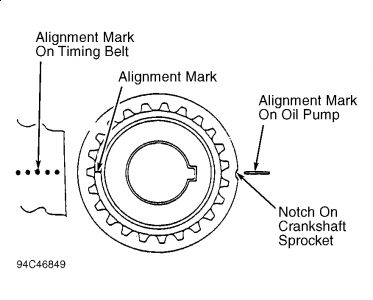

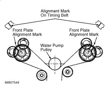

how to replace a drive belt (diagram would be helpful)
Monday, July 20th, 2009 AT 5:45 PM
RACEFAN966
MECHANIC
5,029 POSTS
Here is the diagrams that you requested. The first is for alignment of the cams and the second is for the crank. Thanks and have a great day.
