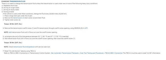

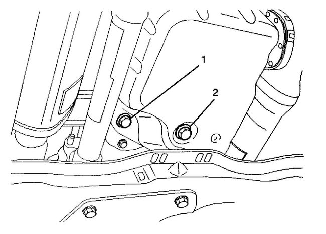

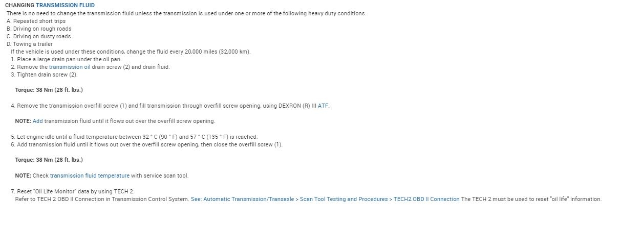

JOE IN DALLAS
This is going to be a messy one.
I have attached the instructions/diagrams below for adding/changing your transmission fluid. Read through them before you start

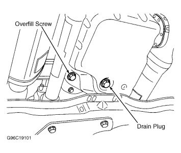

I am trying to figure out how to flush my transmission fluid on my '99 Trooper. First of all I can not find a single manual on the trooper and second the transmission fluid plugs are no where to be found. I have spent countless time going to different auto parts stores and web sites in order to try and find it with no luck. I have even tried to take it in a pay for it to get done but no one will touch an Isuzu that is over ten years old. Any suggestions? Thanks for your help
Tuesday, October 9th, 2018 AT 5:03 PM (Merged)
We do them with no issue as long as you are not trying to fix a failing transmission. You hook inot a cooler line and run 16 quarts of fluid through the system.
The fill plugs are on the bottom pan and it is a process as to adding fluid. It is best done on a lift by someone familiar with this procedure.

You would not happen to have/know where to get drawings on where these plugs are would you? Because I do not see them when we lifted it up a few weeks ago to change out a bad starter. Thanks.
No view that I can see. The drain plug in the bottom of the pan and there is one above it. You inject the fluid into the lower one and it is filled when it comes out the top.

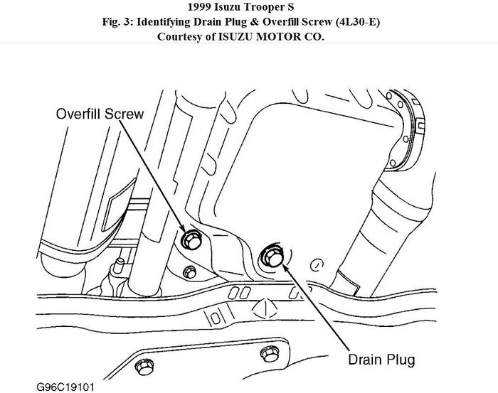

GEORGEBOY
  • 1996 ISUZU TROOPER
Transmission problem
1996 Isuzu Trooper 6 cyl Four Wheel Drive Automatic
where is the transmission fluid plug located at?
+2
Tuesday, September 24th, 2019 AT 8:10 PM (Merged)
BLUELIGHTNIN6
  • 16,542 POSTS
This transmission does not have a dipstick. to check fluid you use the OVERFILL screw that is on the bottom of the transmission oil pan. you will also use this same screw opening to fill the transmission with fluid.
