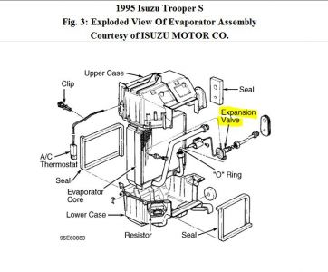

Where is the A/C expansion valve located? Thanks.

Hi there,
You will need to remove the evaporator to access the expansion valve, see pic.
