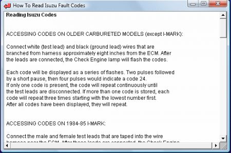

Vehicle would not stay cranked. Had towed to mechanic who states needs new engine computer. Recently had new O2 sensor replaced, however O2 sensor light stay on. Could this be related. Mechanic quoted $1400.00 for new Isuzu computer. Ebay had engine computer for under $200. Recommendations.

Try reading the codes first, see what flashes and post them. Has the fuel pressure ben checked?
https://www.2carpros.com/forum/automotive_pictures/62217_Isuzu_1.jpg
