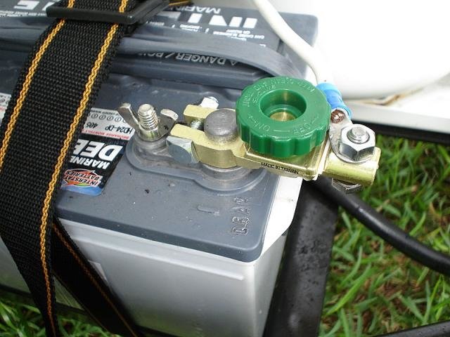

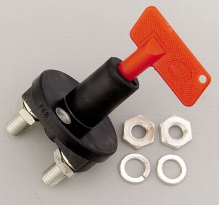

BUDDYCRAIGG
  • 2,262 POSTS
I guess you are against the idea of using something a little low tech.
like
https://www.2carpros.com/images/question_images/199255/original.jpg
or
https://www.2carpros.com/images/question_images/199256/original.jpg
Sunday, January 4th, 2009 AT 6:22 PM

Thanks for the reply Buddy! You are the greatest help I have found on the Internet.
I ordered one of the battery disconnect switches like you posted, but was concerned that I couldn't run a heavy battery cable into and back out of the cab to the battery and if I couldn't do that and installed the switch under the hood I would still have to remember to raise the hood each time I stopped to turn off the battery disconnect switch. The length of battery cable stopped me from this idea that even I had though of as a first and easy fix.
