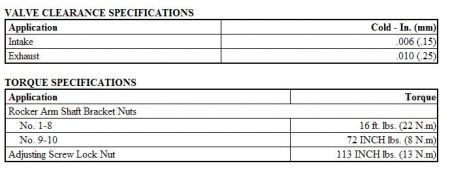

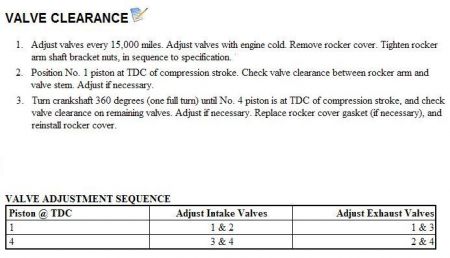

The motor makes a tapping sound when running. I have been told that this was a lash adjuster. How expensive is this to repair. Can I do it?

https://images.2carpros.com/forum/automotive_pictures/261618_Noname_1578.jpg
https://images.2carpros.com/forum/automotive_pictures/261618_Noname2_482.jpg
https://images.2carpros.com/forum/automotive_pictures/261618_Noname3_180.jpg
