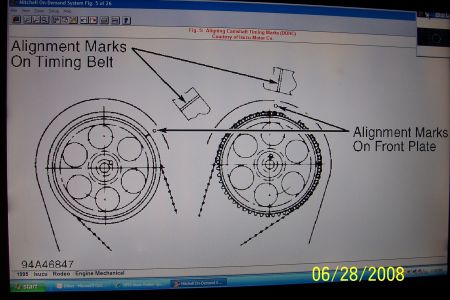

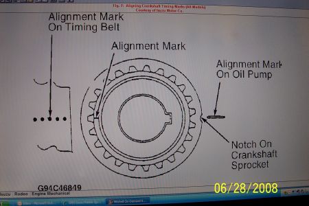

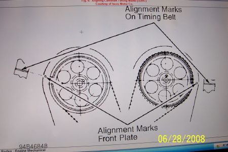

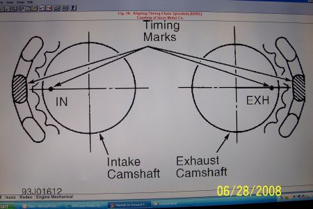

I have an isuzu rodeo that has mismatched timing between the crankshaft and camshaft positions. What is the proper procedure for setting the relative positions of the crankshaft and camshaft pulleys before installing a timing belt?
Friday, June 27th, 2008 AT 2:28 AM
OBXAUTOMEDIC
  • 3,711 POSTS
Here are the settings......
Camshaft Timing Marks on DOHC
https://www.2carpros.com/forum/automotive_pictures/188069_100_2485_1.jpg
https://www.2carpros.com/forum/automotive_pictures/188069_100_2490_1.jpg
Camshaft Timing Marks on SOHC
https://www.2carpros.com/forum/automotive_pictures/188069_100_2486_1.jpg
Crankshaft Timing Marks
https://www.2carpros.com/forum/automotive_pictures/188069_100_2487_1.jpg
