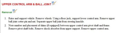

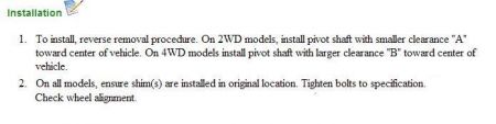

whats the best way to replace the upper balljoint
