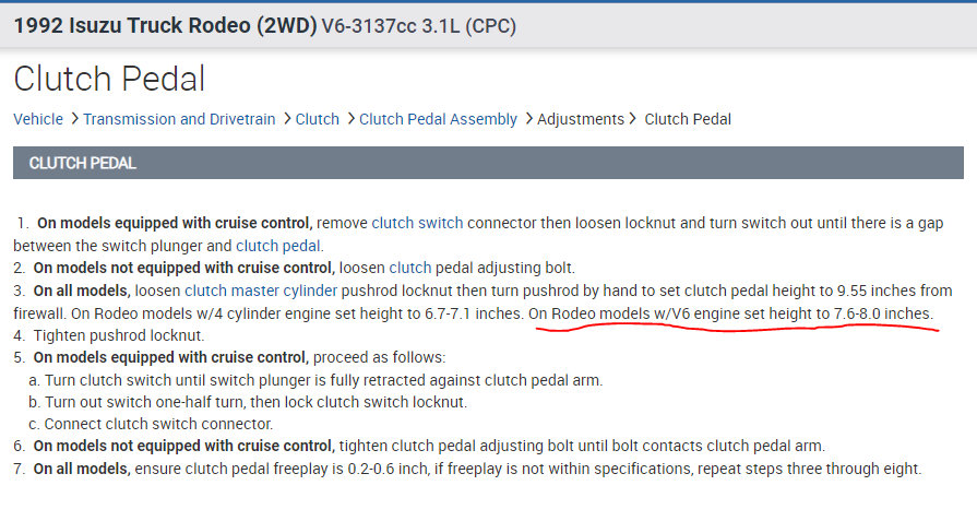

I have 1992 Rodeo 3.1 v6 rwd with Borg Warner, my other 92 Rodeo 3.1 4x4 with mua never gave me clutch pedal issues like the borg warner. my clutch is good but since last fall playing in mud my clutch pedal has been giving me issues. I've replaced pedal assembly and now hydraulic hose. Pedal still somewhat on floor , I've bled several times, there doesn't seem to be anymore leakage. so I'm hoping I just need to adjust pedal , or the hose brackets were put on reverse of how it was. could that make a difference? Or is pumping bleeder too much causing more air bubbles?

And right now engine will not turn over for pedal not in play correctly. input would be appreciated.

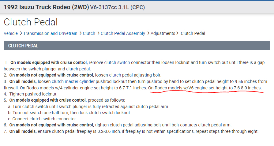

Here is the information you requested. I've attached a picture step below on how to adjust the clutch on your Isuzu. I've underlined your specification in red. Here is a tutorial showing clutch symptoms:
