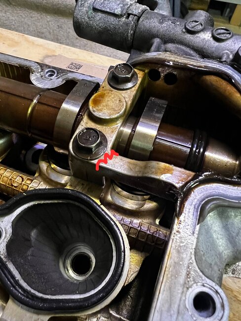

Is this crack in my Cam Cover a problem?
2007 SUBARU LEGACY
180,000 MILES • 2.0L • 4WD • MANUAL
SUBARU-GARY

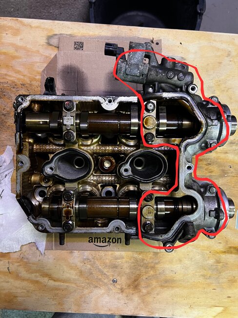

I agree, this one is strange. I need to know if it's an issue or even necessary to repair? Maybe have it welded? It doesn't look like it is holding anything.
It's a difficult part to find since it's part of the head.
The following 3 photos.
IMG_5059 is the actual break on the drivers head
IMG_5060 is a reference to the part and place

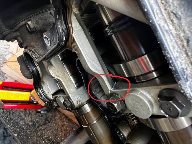

IMG_5061 is a close up of where it is cracked but on the other head.
Of course I understand it's holding the cam in place the bolt and actual bearing cover is in tact.
What do you think.
Finding the part is hard (thought I do have a guy), if too expensive, not worth the value of the car.

Yep, that is the end of that camshaft cover, you need a new one or have it welded, sorry. Thanks for the images, they helped.
