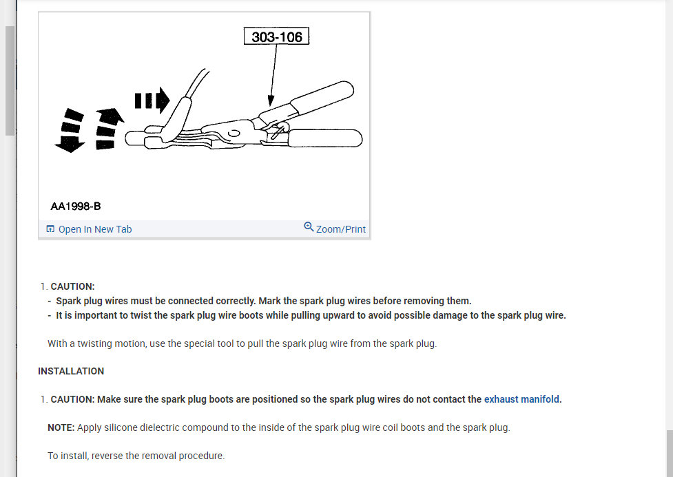

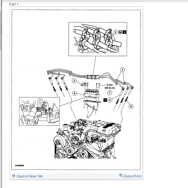

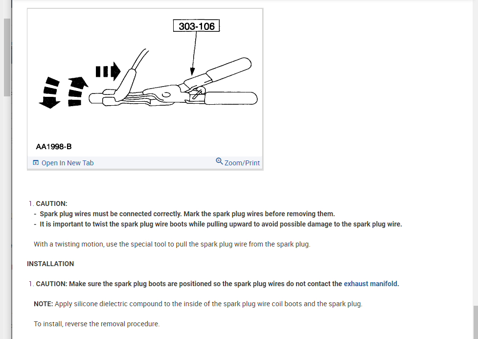

Is there a pattern to change the spark plugs?
Monday, June 21st, 2021 AT 3:04 PM
MECHANIC
18,907 POSTS
There is no pattern to changing them. Just change the all is all that matters. Here are some guides that will help with this:
https://www.2carpros.com/articles/how-to-tune-up-a-car-engine
https://www.youtube.com/watch?v=e68QXyBAiZo
Here is the process from the manual that shows how to replace them. Please run through all this material and let us know if you have questions. Thanks
