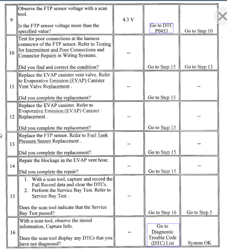

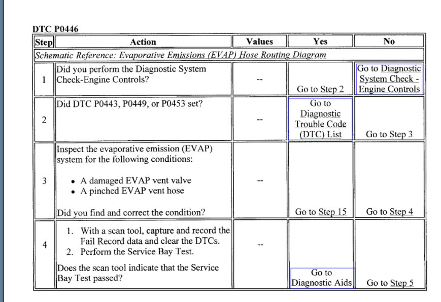

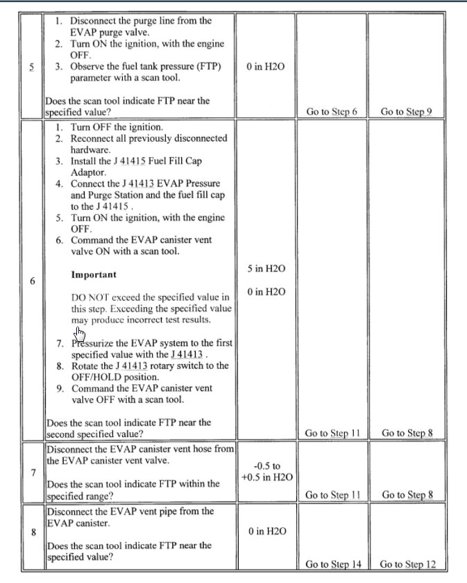

I have no codes relating to 02 and the heated 02 passes, but not the regular 02 sensor. The EVAP is failing as well codes p0449 and p0446 (no service engine light though, yet). EVAP has failed before without causing other things to fail or not complete.

This could be a couple of things. First and foremost it could be the o2 sensors, purge valve or a couple other items as well.
I attached the testing that we need to run through in order to figure this out for sure.

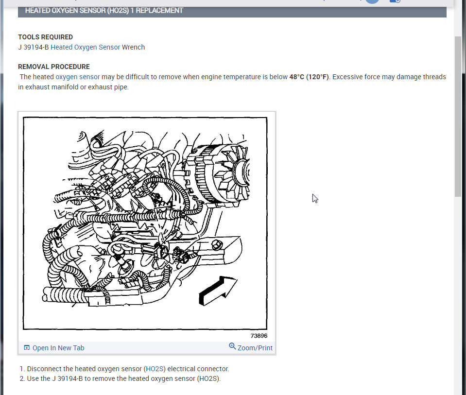

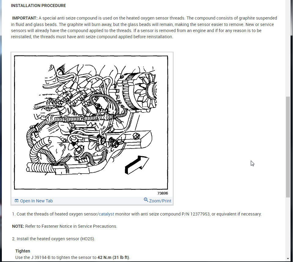

However, I also attached the instructions on how to replace the o2 sensors as you requested.
Run through this material below and let us know if you have questions.

Hi:
The O2 sensors are on the exhaust. One is upstream and one down stream (cat), and they almost look like a spark plug. They are easy to replace. They just screw out and in and have an electrical plug. However, I recommend that you purchase antiseeze and put some on the new sensor's threads before replacing them. Also, you don't need to do anything to the computer.

Turn on vehcle and let it warm up. Be careful exhaust will be very ot.
With engine off locate oxygen sensor that needs replacement and disconnect the connector keepign it away from the hot pipes.
After that you will have to use a special socket or a box end wrench and procede to loosen it making careful not to strip it out or hit the hot exhaust.
When installing the new one use antiseize compound.
