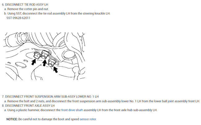

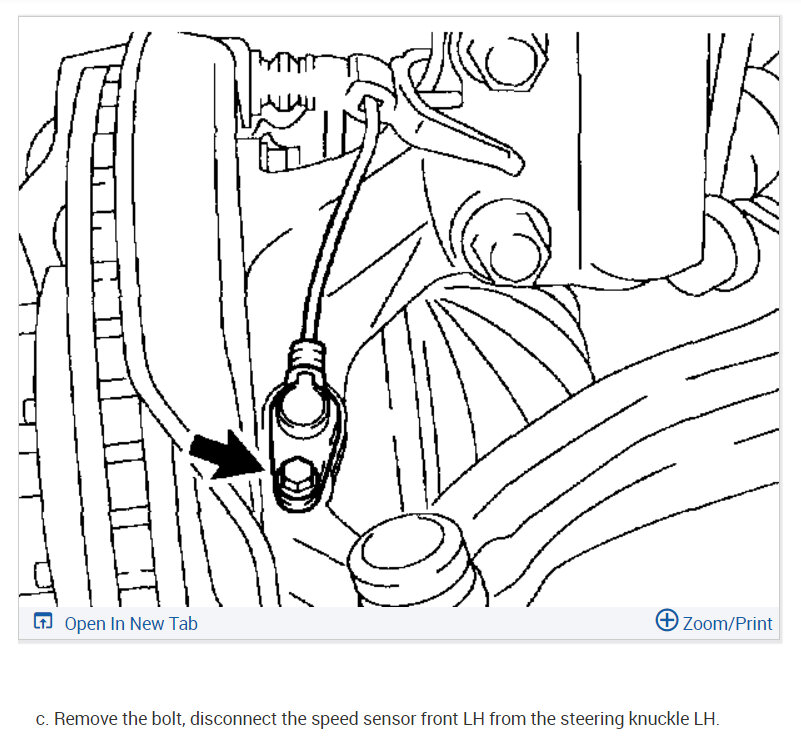

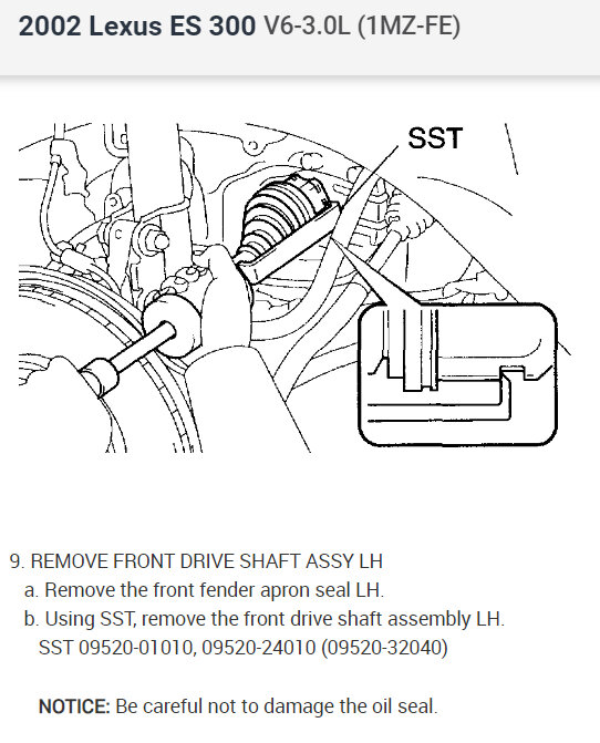

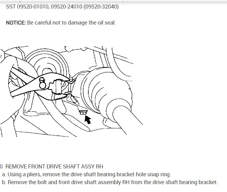

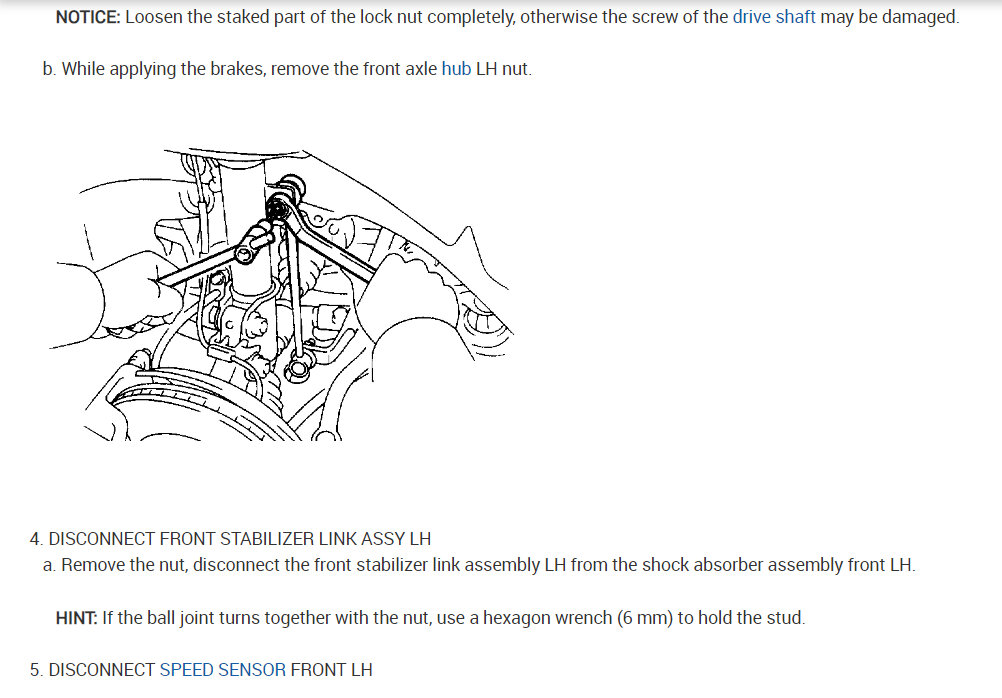

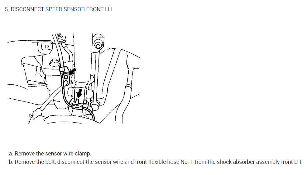

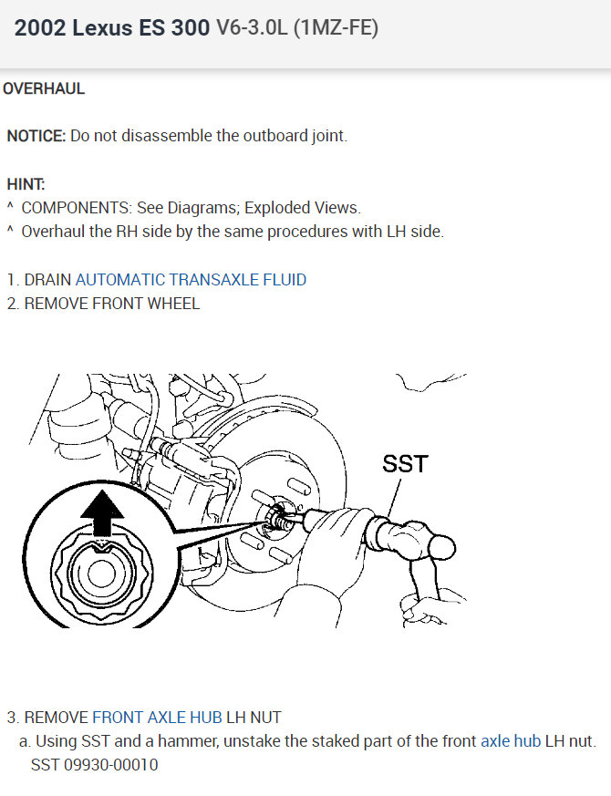

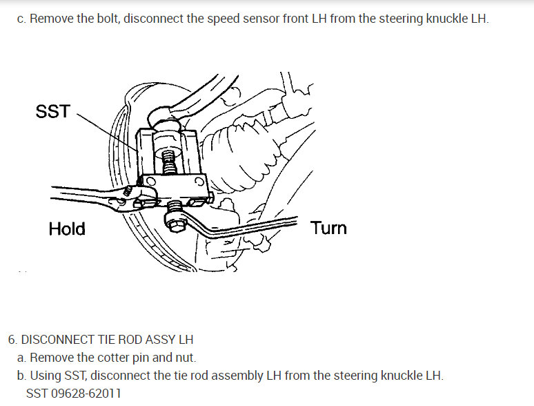

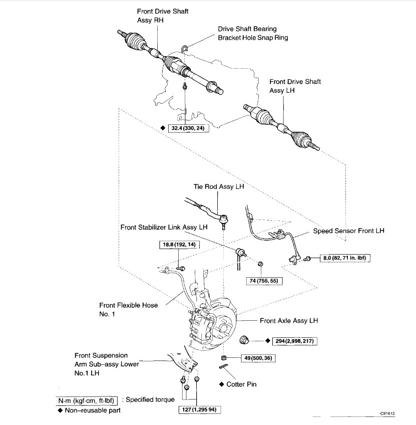

You did good, thanks for the video. It sounds like a cat was trying to help you lol. The CV axle looks bad, and it needs to be replaced. I would not drive it anymore because if it fails the car will be stranded. A replacement axle on amazon is like $65.00 and easier than trying for a boot kit, plus it looks like the CV is worn out anyway. Can I ask if when in the accident did it shift any suspension or engine mounts? how bad was the accident? Can you upload a video?
Here is a video of the drive axle being replaced and I have included instructions on how to do the job on your car in the images below.
https://youtu.be/F7CsYAG4w3M?si=wHg5nx0pY1CTvFI7
This guide may help as well:
https://www.2carpros.com/articles/replace-cv-axle
Check out the images (below). Please upload pictures or videos in your response of any problems so we can see what to help you with.

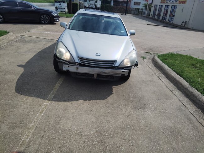

Hi, thanks for the reply. I got the CV axle changed out last night and about to take it on a test drive now I included a picture of my car after the accident below I really hope nothing else is messed up because I'll be doing it myself I only had basic liability coverage no under or uninsured motorist even this guy cut the off pulled in front without looking then tried to take off but I got his plate and I'm waiting to see if he had insurance or not if there's any other pics or angles. Let me know and I will take them. I'm hoping that's all it messed up and hopefully won't need to but will update if there are any further issues, thanks.
