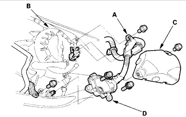

2002 Acura tl type s D5 light continually blinks. CEL is on (p1709), VSA light is on, and the ! Inside the yellow triangle is on. Seems like its shifting harder than should. Also, at low throttle and lower speeds, intermittent loud buzzing(?) Sound from the engine bay
Does that sound like a neutral safety switch?
Sep 13, 2025 at 3:51 PM
  • 54,494 POSTS
Yep, this would be a gear range sensor issue (neutral safety switch). Here is the location so you can swap it out and then clear the codes. Check out the images (below). Let us know how it goes.

Installed the NSS and cleared the codes.
After turning the key to the acc position, the code/lights came right back after a few seconds.
What should I look into next?
Oct 2, 2025 at 11:32 AM
  • 54,494 POSTS
Yep, is because the shifter is not seeing what the transmission is which can be due to a worn shifter cable, can you move the shifter into park through 1st gear cleanly?
