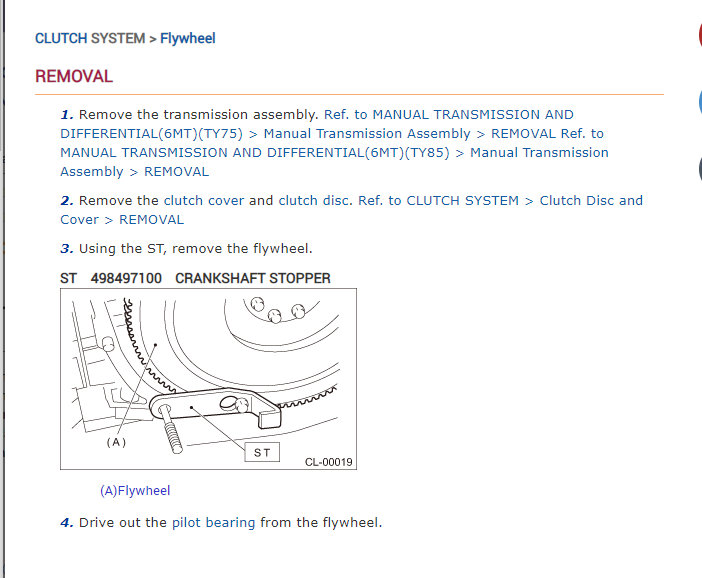

I included the process on how to change the flywheel in case you need it.
Clearly just unbolt the flex plate and then install the flywheel.

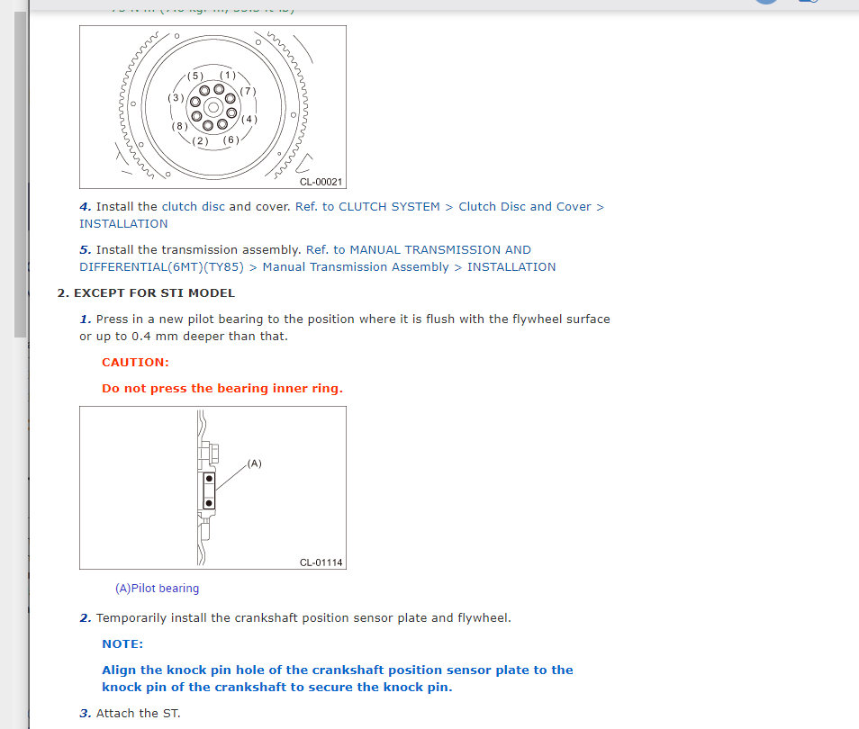

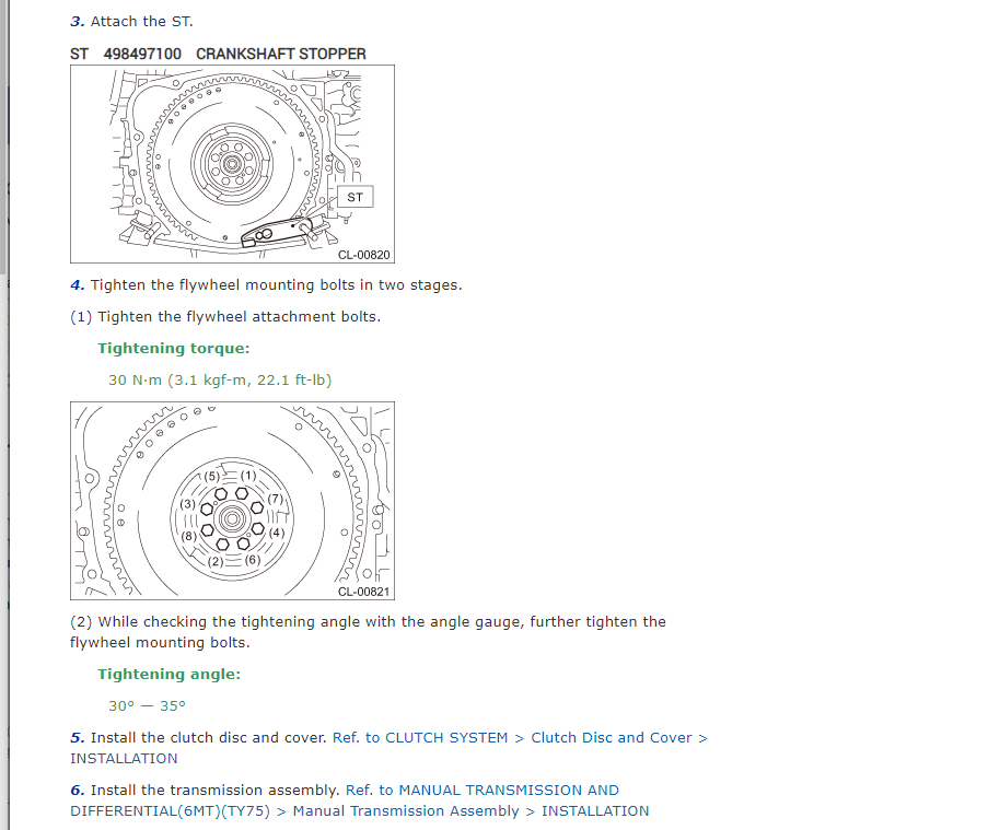

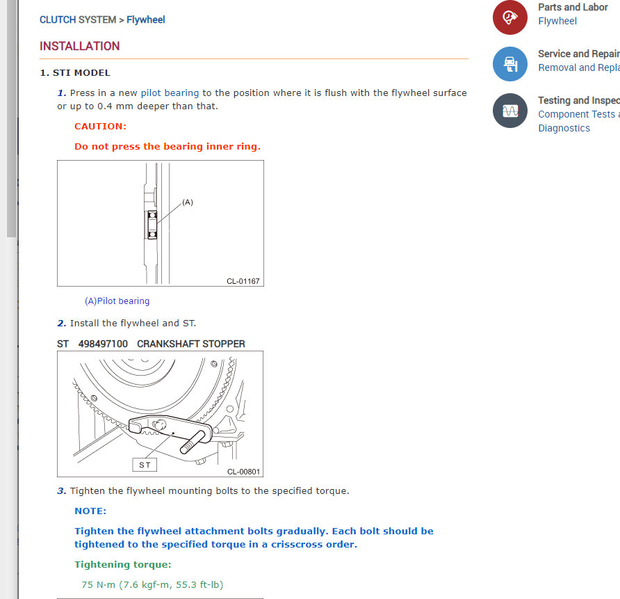

Thanks, makes sense. I had the numbers for the flywheel bolts as 55 ft/lb, but I see it here as 22?
Tuesday, September 21st, 2021 AT 4:57 PM

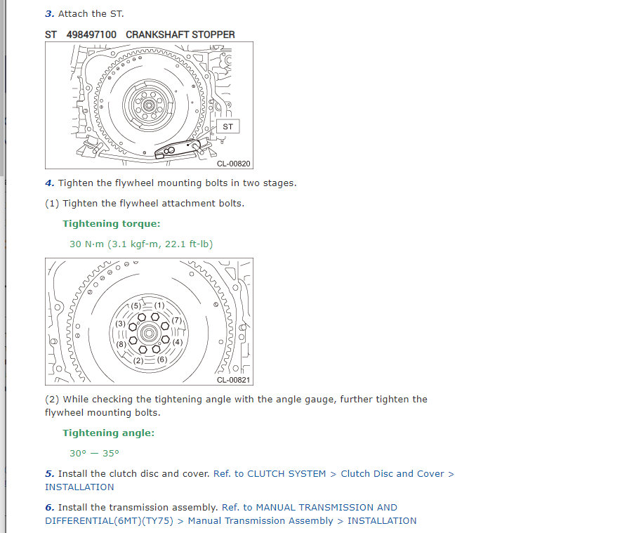

Correct. However, look at the step below the picture in step 2 on the last page.
Torque to 22 ft lbs but once you get them all to 22 you go in the same torqueing sequence another 35 degree turn.
This means you can use a protractor to figure out the proper angle for 30-35 degrees or get close to it. Clearly half of 90 degrees is 45 so on a clock, you go from 12 to just past 1 or almost 2 o'clock and that will be about 35 degrees.
However, this would more than likely come to about 55 ft lbs but they want you to go in stages so that it doesn't warp the flywheel.

I have a torque wrench so I will go 22 everywhere then go in a cross pattern to 52-54 I guess.
Tuesday, September 21st, 2021 AT 7:00 PM
Yeah. You will be fine. Thanks. Let us know how it turns out.
