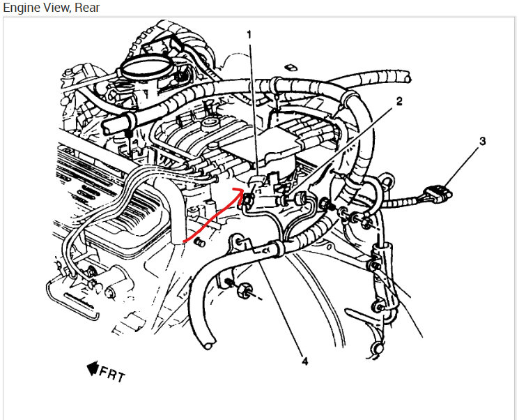

Sometimes starts fine, other times doesnt want to start. Just replaced the coil pack, wireset, spark plugs , distributor rotor and cap. No spark to plugs about to check to see if coil to distributor has spark but was wondering where camshaft positioning sensor is

I don't think the camshaft sensor will not make it start but you can try it. Also, I would check the compression as well. Here is a video to help you check which system is not working to help narrow the problem down.
https://www.youtube.com/watch?v=lXLJbuAZ4CE
Here is the location of the camshaft sensor, we need to see which system is failing to pinpoint the fix. Also, can I ask if the security light is flashing while you are cranking the engine over? If so this is the problem. Please upload a short video in your response of the problem, so I can see what's going on. Check out the images (below). So there might not be a camshaft sensor depending on the date your truck was made, here is the location if your truck has one. Ken
