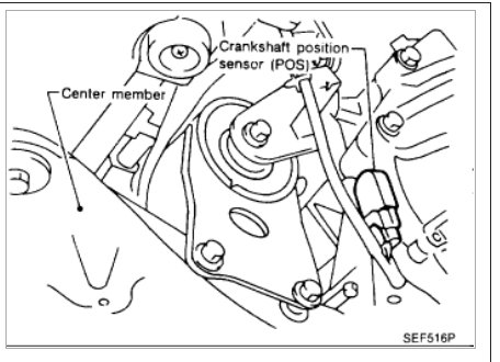

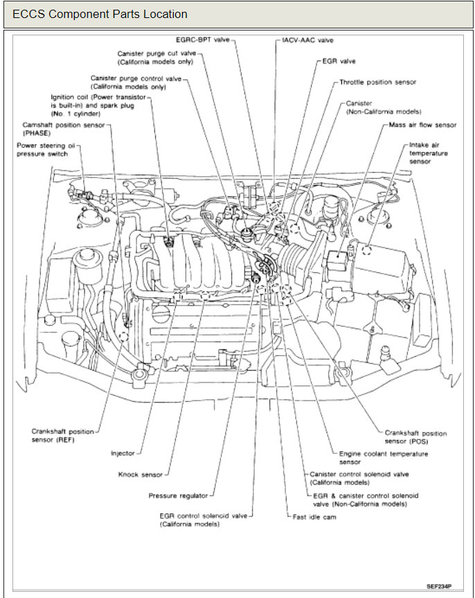

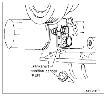

Yes, it does have two crankshaft sensors I would replace both of them. Here is a guide to help you see their location and a guide to help you see what you are in for when doing the job:
Wednesday, April 25th, 2018 AT 9:34 AM
PISAKI
  • 6 POSTS
Hi Ken,
Thanks for sending me those image details on how to locate both crankshaft position sensors on my Maxima, I really do appreciate it. Also, your link to the replacement video was very helpful because of the tips that I never would have thought of. The parts are not that expensive so I decided to order both of them and hopefully I will not have too much trouble with getting access to where they are located.
