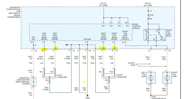

One headlight works at a time. DRL driver side, Light switch on low beam passenger side works. High beams and driver side works. Both on if you hold switch. Replaced light switch, dimmer switch, front body module. Filed posts. Checked wiring in IPM. Didn't find any loose or frayed wires.

When you checked the IPM, did you unplug the connector related to lighting? Often times the pins will corrode and break. Take a look at pic 1 below. Let me know. Also, you will need to check those pins to see if there is power to the light not working.

Tried it all. As lights are on alternately power must be okay. Cleaned pins, used electrical goo (?), Traced all ground wires. Took dash apart, checked all and all okay. Mystery. Taking to a diagnostic center tomorrow. All worked on one morning when it was raining. Not worked since. All wiring looks fine.

Appears to be IPM. Will cost more than car is worth. May try to wire direct to low beams. Have already replaced main computer, brakes, starter, ignition, water pump, fuel pump over 7 years. Hard to know what to do with so many parts new. Very limited income. Thanks for your help.

What I would suggest is to find an IPM online. There are companies (not individuals) that sale both remanufactured one and new ones. Once you get it, replacement is a little difficult, but not too bad. I can provide the directions if you need. If you do it yourself, it will be much cheaper.

It was IPM. Got from bone yard for $175.00. Installed. Everything works! Thank you for all your help. Hope this helps with next guy who has the same problem.
