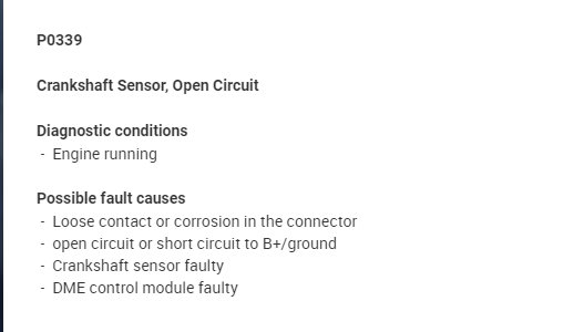

Intermittent hard start with backfire
2006 PORSCHE CAYMAN
90,000 MILES • 4.0L • 6 CYL • 2WD • MANUAL
VASSZ
Happening more and more frequent now.
cranks but won't start. after you keep trying, it backfires.
sends a p0339 code which is crank sensor.
changed it but same problem.
Oct 5, 2020 at 3:53 AM
  • CAR REPAIR CONTRIBUTOR
Have you replaced the crank sensor? More then likely this is starting to fail. If not then we have a connector or wiring issue. However, due to it being intermittent this sounds like a contact issue in either the sensor or the connector.
Let's start with this and go from there.
