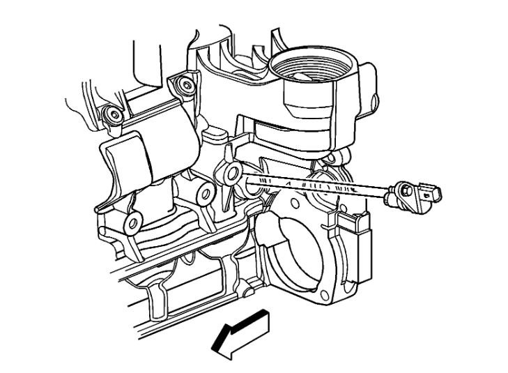

If the car sits for a couple days, it stalls when I depress the gas pedal or turn on the A/C. This problem only seems to happen during the spring and summer when it's humid outside. If I drive for about 20 minutes, the issue seems to resolve itself. There are no check engine codes when it happens. The car has no issues when it's cold outside. Dealer replaced mass airflow sensor and throttle body, but the issue still persists. What is causing this to happen?

This could also be a crank sensor.

The experts at my local GM dealer are clueless as to why it stalls. I don't have any faith in their troubleshooting abilities. I Googled and came up with the CPS being the possible issue, however I don't want to just blindly start replacing parts with the hope of fixing it.

I agree with the crank sensor. That's what I posted. A good tech with an advanced scan tool to monitor the activity of the sensor especially when the event happens to see if it is the sensor dropping out.
