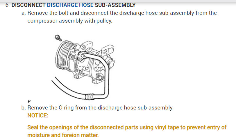

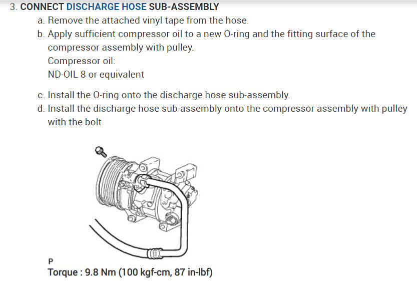

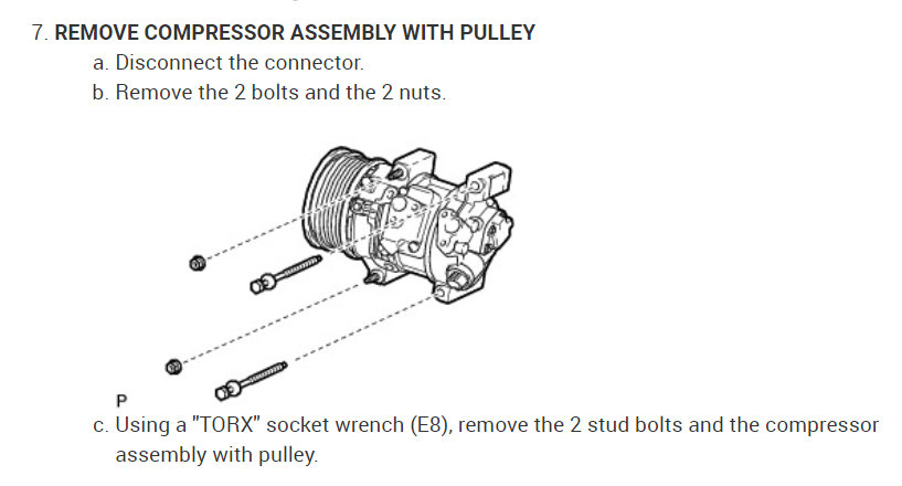

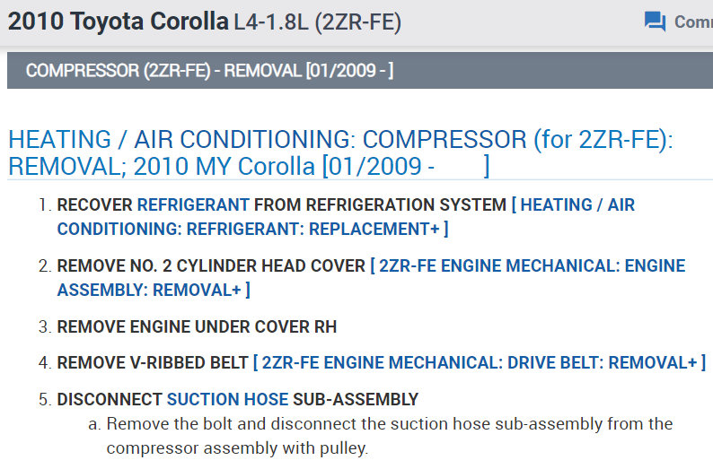

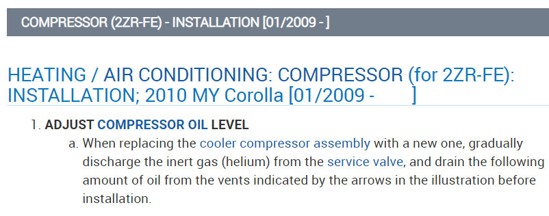

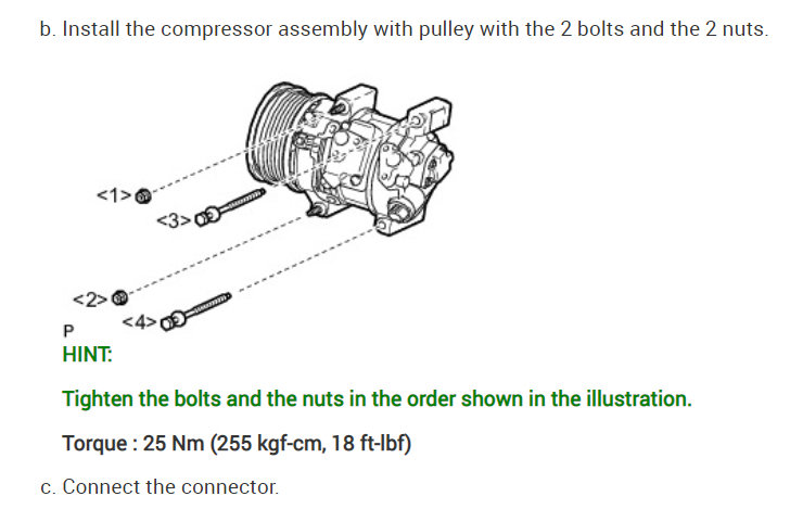

Hello, I'm Danny.

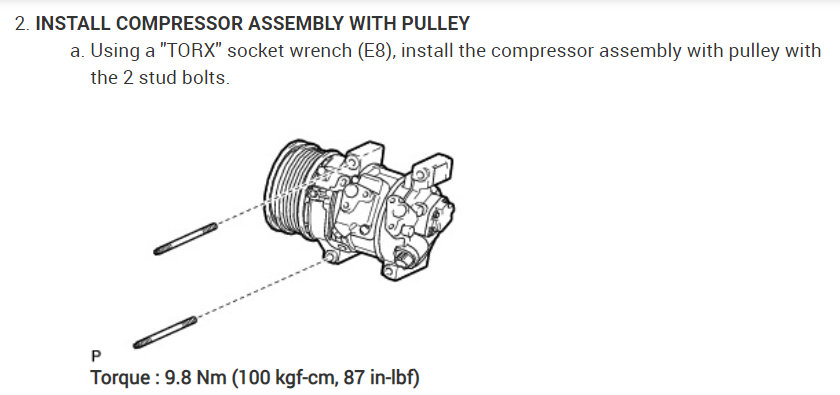

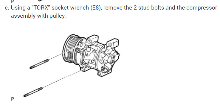

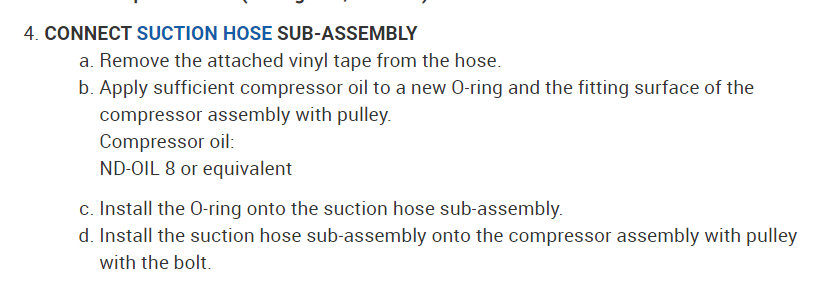

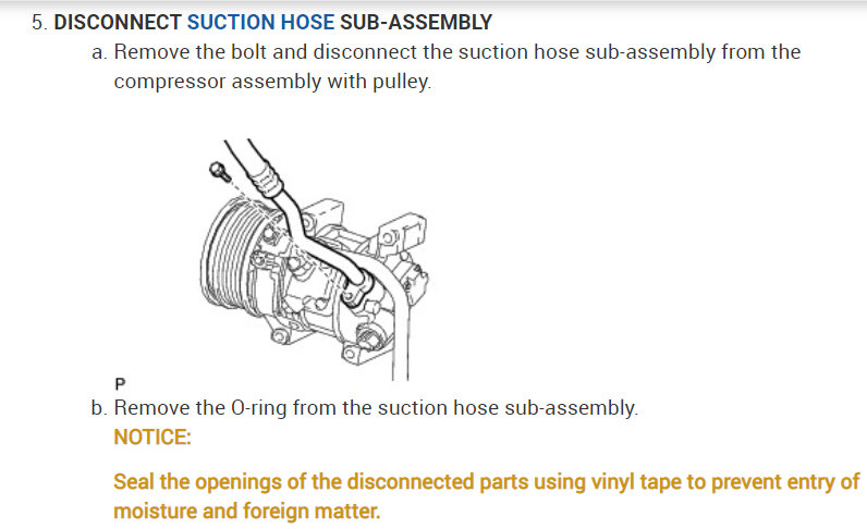

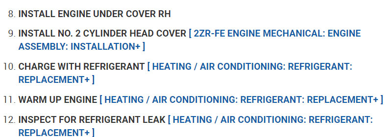

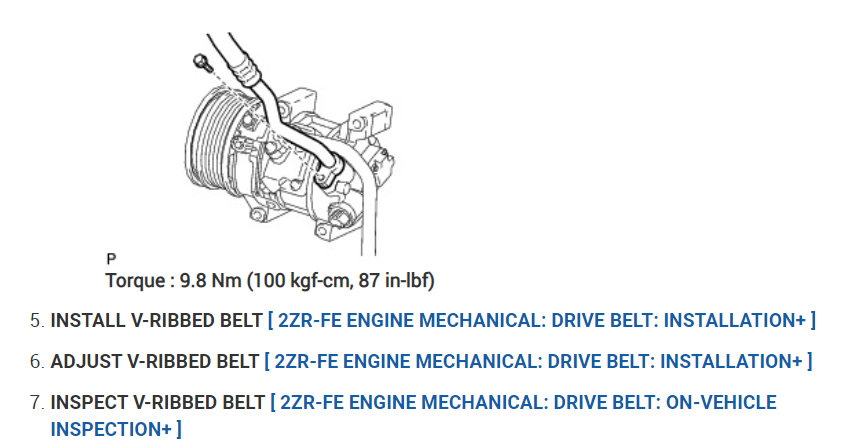

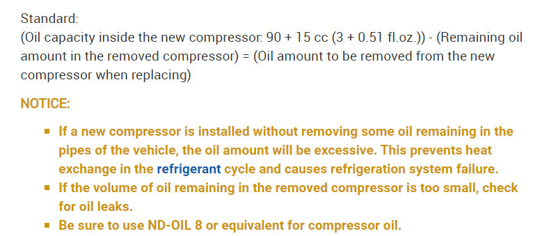

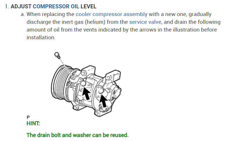

Here is a tutorial showing how to replace an air conditioning compressor:
https://www.2carpros.com/articles/replace-air-conditioner-compressor
I've attached picture steps below on how to replace the air conditioning compressor on your car. Hope this helps and thanks for using 2CarPros.
