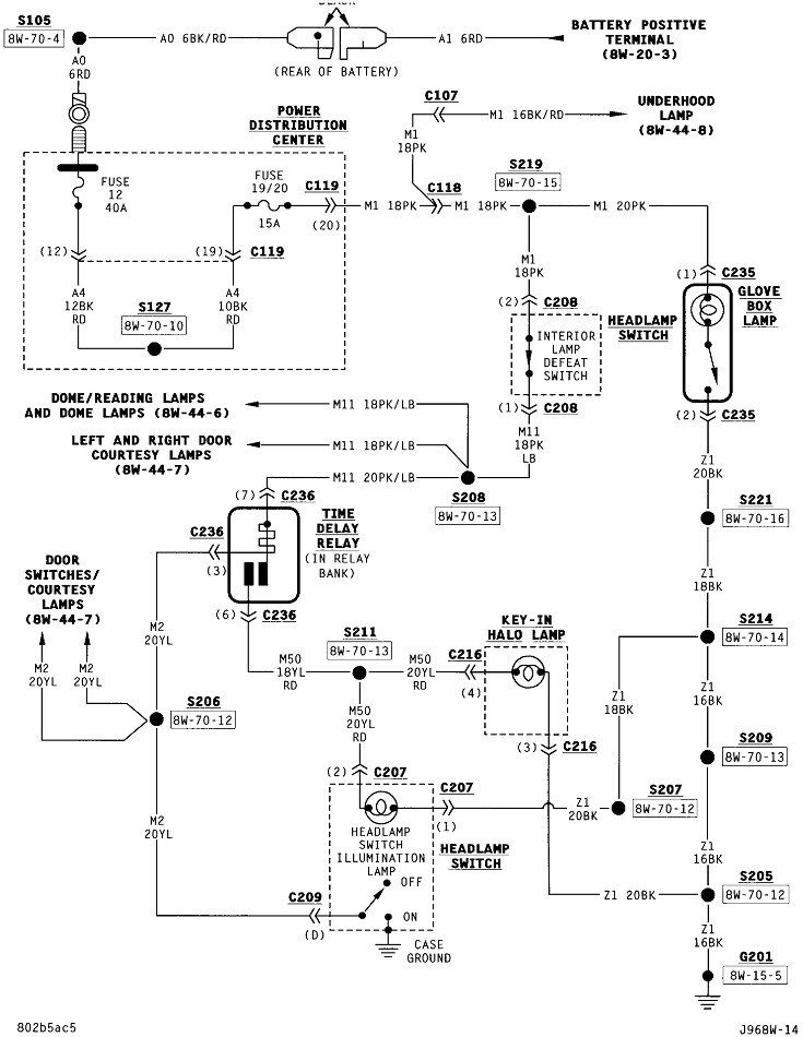

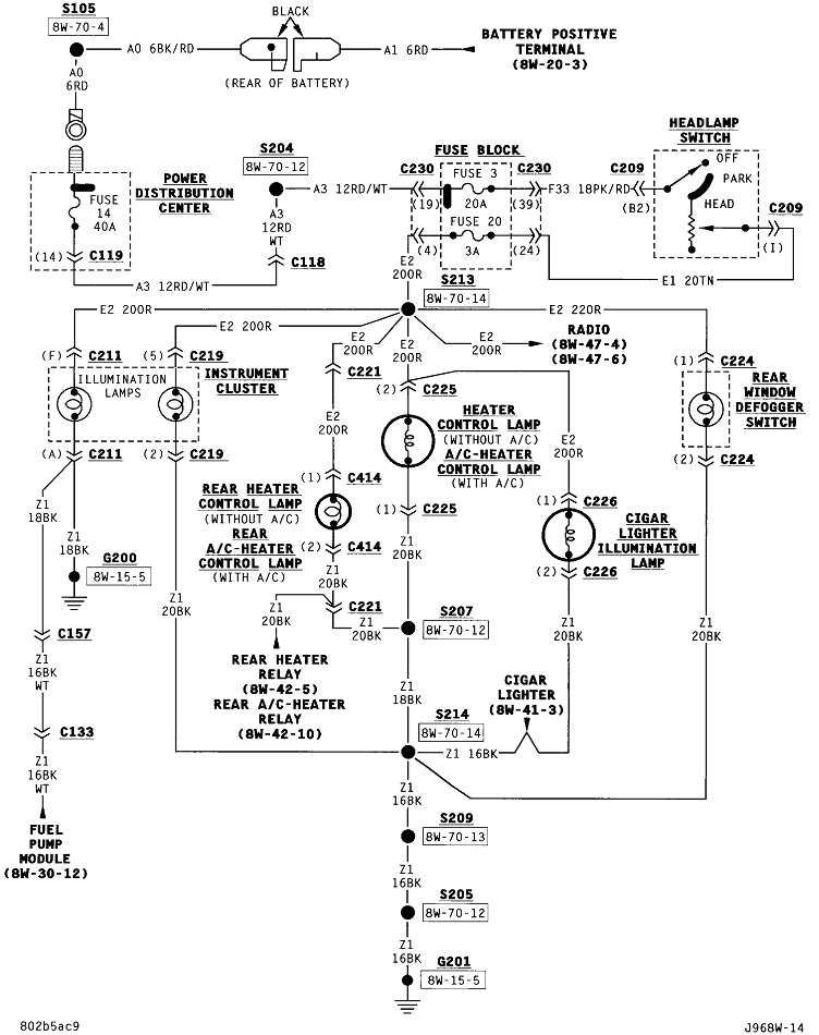

Before this issue, turning the headlight switch knob to the right, after the click, would keep the interior lights off, even when I opened the doors. Turning the headlight switch all the way to the left after the click would keep the interior lights on continuously. That was perfect. Now, however, when I turn the headlight switch all the way to the right, the interior lights stay illuminated. In addition, I've noticed that when I have the doors open and I turn the headlight switch knob all the way to the left the intensity of the light increases just a tad. I must tell you this is after I installed a radio system. Also, when I pull the interior fuse from the panel under the glove box, the lights stay on. In fact, I can remove all of the fuses under the glove box and the lights will stay on. These are the interior lights I'm talking about not the headlights. The only way I can get them to go off and actually stay off is to remove the fuse under the hood inside that fuse panel box near the battery. It's a tiny little single like I don't know 15-amp fuse or something. You put the fuse in it's a mini fuse, and then you have to push down on this yellow cradle that it goes into, if that helps you at all. So, can you please tell me what I did to mess up and how I can fix it? Thank you in advance.

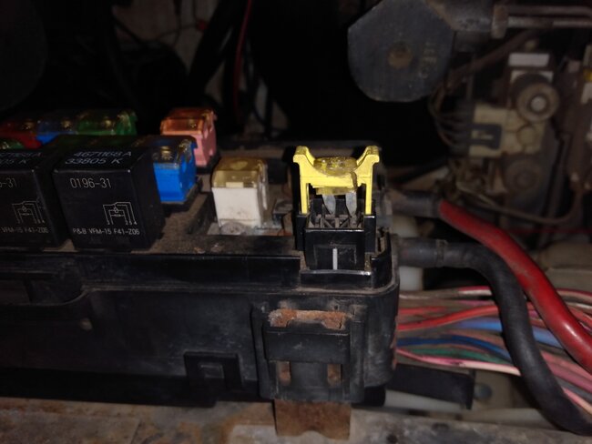

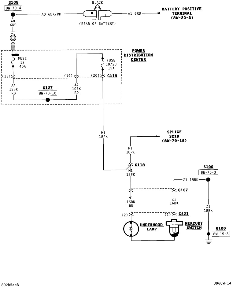

To address the yellow fuse holder, there are two fuses in that. Anything bright yellow is associated with the air bags. The holder is designed to identify those fuses and make it fast and easy for rescue personnel to disable that system. It can also be referred to as the "IOD" fuse, for "ignition-off-draw". That feeds all the computers, and the radio, that need a 12-volt memory circuit.

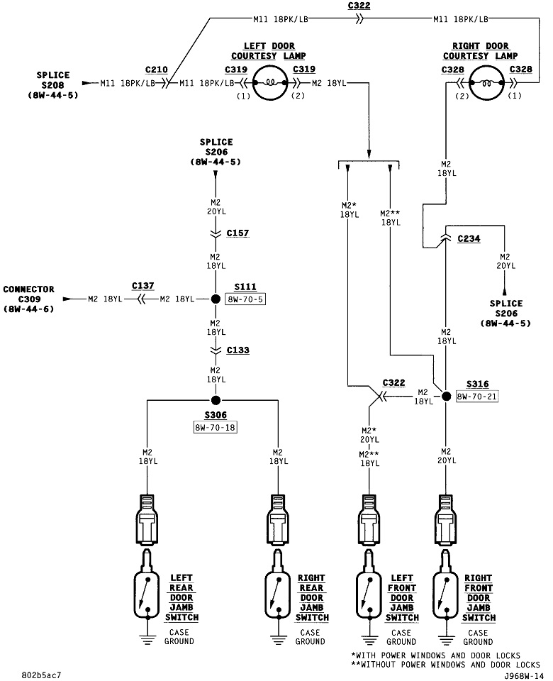

Dandy. As long as the original radio wiring wasn't modified and no adapter harness shorted two circuits together, it appears safe to rule out the radio installation as a cause for this problem. Is this a conversion van? If it is, you're going to have to take the lead and I'll help as much as possible. The people at the dealership I worked at were never able to find me any wiring diagrams from the conversion companies. What I posted below are the original Chrysler diagrams for the interior lights. I did see a reference to a conversion relay on the last diagram, but I haven't studied it yet. Other than the first one, the rest will probably be irrelevant, but I'm posting them anyway so you'll have the complete system. I'll look at them closer when I get home to see if anything sticks out.

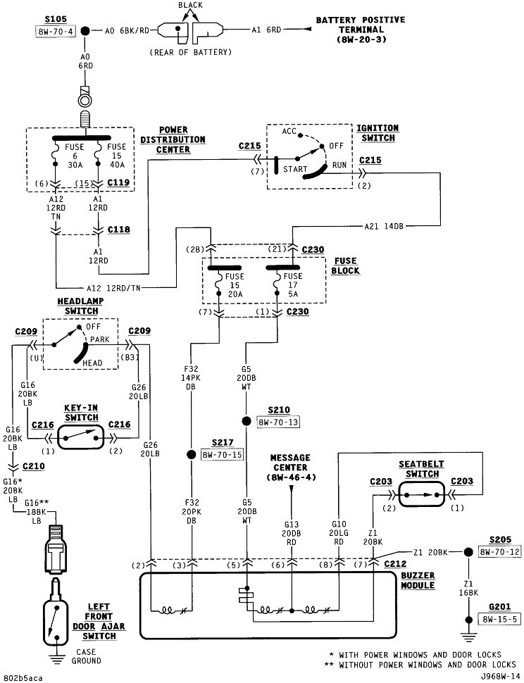

For now, start by unplugging the head light switch. That includes the "interior lights defeat" switch. If the interior lights stay on, we have a definite short to look for. If the lights go off, that switch is suspect. I'm trying to remember for sure, but I think there's a metal or ceramic disc you rotate with the knob, and it has a bump on it to push a metal tab to turn the switch off. Check if that tab is deformed to the point the knob isn't pushing it enough.
I can't remember how that head light switch comes out. You might have to remove the upper dash cover, otherwise, go in from under the dash. On top of the switch body, there's a small metal spring-loaded button to press down, then pull the knob off with the stem that comes with it. Once that stem is out, the switch is held in with a thin nut right under where the knob was. With that nut removed, the switch can be pulled out the back of the dash.
You may find the switch is mounted to a small panel that can be removed after removing four screws. If neither of those looks right, and you can't figure it out, I'll look for the instructions and post them for you.
Let me know what you find up to this point. I'll be back about this time tomorrow to see how you're doing.

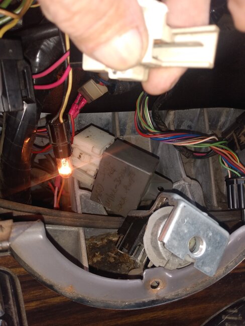

DAVID ENDACOTT
  • 19 POSTS

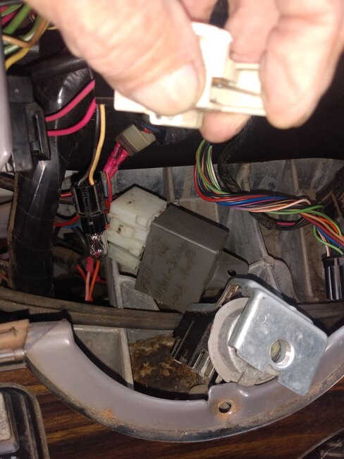

The first one is the fuse under the hood. The second and third one is the light switch. I can't find the button that you said was on top to remove the shaft.

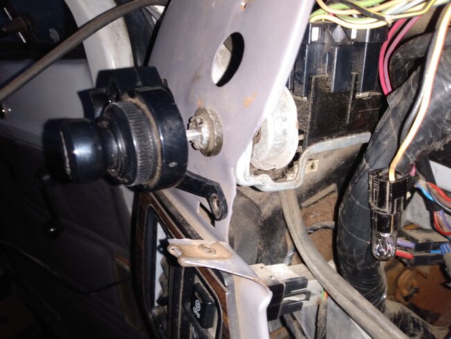

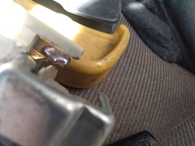

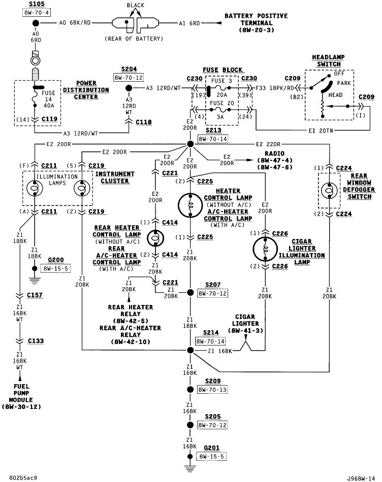

Caradiodoc, I won't forget you. You're an angel, in my book! After reviewing the diagram, you sent me, carefully reading your reply, and considering the responses you've made to other members regarding similar issues, it turned out to be the switch itself on the headlight switch assembly. I've enclosed a few pictures. Anyway, it works Hunky Dory now. I'm not going to worry about that white and black wire that's just hanging down by the feet on the driver's side. Man, oh man, this was a real pain in the Yahoo to take apart and figure it out. My hands and arms are all cut up LOL. I don't know how the factory people do this every single day and not get torn up. My hands and arms look like I've gone through a cheese grater. Anyway, sir, I want to thank you from the bottom of my heart. I wouldn't be in this situation if I had money, but what I can offer you in return for your effort is knowledge of air conditioning, heating, and appliances. If you have any questions about air conditioning units for homes or major appliances, please don't hesitate to email me, and I'll do my best to help you. The pictures I attached show the broken switch, as well as the knob and shaft removal button.
Additionally, I aimed to demonstrate the switch's functionality. I believe the main culprit was the tab that strikes the actuator of the 'constant on' switch. That, and perhaps a bit of Grease buildup located on the plate which contacts the part which turns when you turn the knob, if that makes any sense at all. Of course, nothing would work correctly with the switch broken away from the body of the headlight switch assembly. Anyway, sir, thank you very much and have a wonderful day!

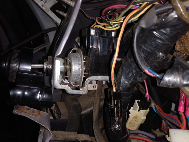

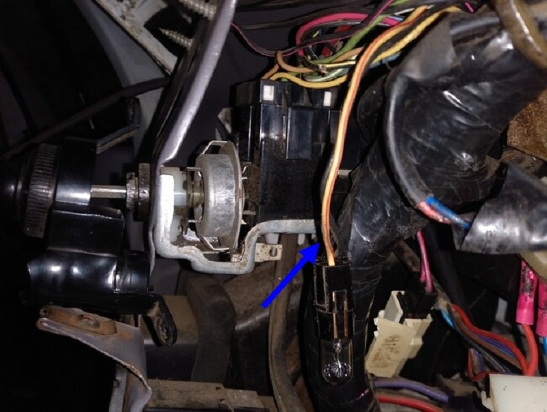

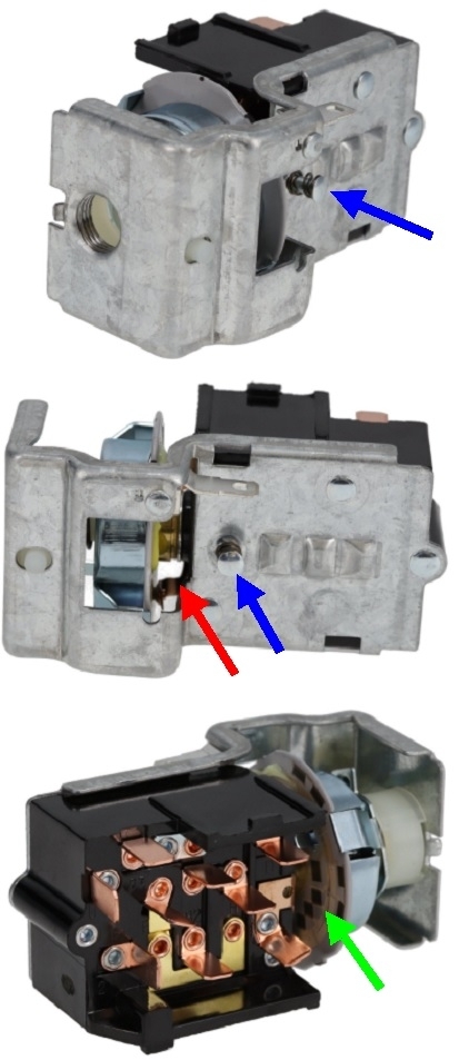

Well frog fuzz! I'm happy to hear you solved this. I didn't see your additional replies before I put some photos together. By now I assume you found the button to remove the knob. The second photo shows it with my nifty blue arrows. It won't press if you're pulling on the knob, in fact, sometimes you have to push the knob in just a little, then the button will press.
I'd have to look at the switch face-to-face to be sure, but I think my green arrow is pointing to one of the interior light switches. I suspect the other one is built into the main body since it switches 12 volts, not ground.

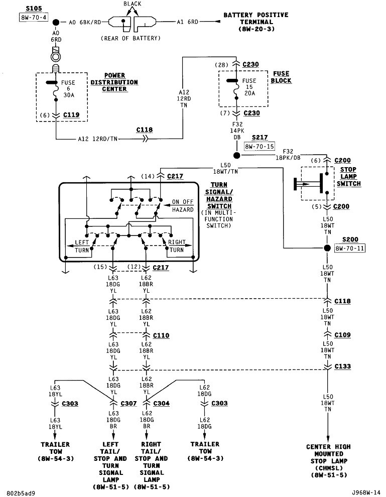

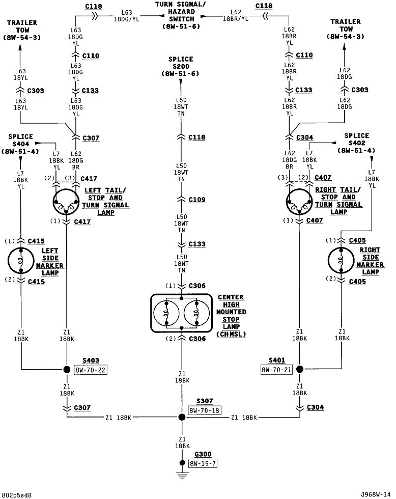

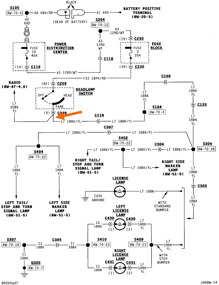

Check if the front running lights work. If they do, we can rule out the head light switch. If they don't, check if the radio display dims when you turn on the tail lights. If it does, that also tells us the switch is okay.
If none of those things work, check for 12 volts on the black / yellow wire on the head light switch connector. They show that as terminal "R" on the body of the switch.
I seem to recall hearing something about the wrong switch being provided by some parts houses, but that would have been a long time ago, and I can't remember which models that involved. If there's no 12 volts on that wire with the switch turned on, reinstall the old switch and see if the tail lights work.
Also, don't overlook fuse # 3, a 20-amp. If that is blown, start by checking for a chewed-up trailer harness. I used to see that quite often on Caravans when people wrapped the harness around the hitch, then drove up an incline, like when going into an uphill driveway, then the hitch would get close to the ground. Also, in the mid '90s, U-Haul had trailer harnesses with three red LEDS in the connector to show which circuits were on. It was common for something to short in that connector and cause fuses to blow.

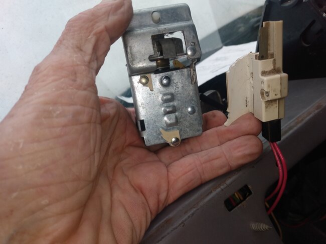

Yes, he is one of the best. I'm sharing the picture here. I hope he sees it. This is my afro-engineered repair, so I don't have to replace the whole thing. I soldered a little piece of a paper clip to the switch lever. Now, the knob actuator engages perfectly! It ain't pretty, but functionality over form, right? Lol.

You guys are too kind. I'm quite familiar with this type of repair from my years as a tv repairman. Funny thing is, we used to roll our eyes when we'd run into what someone else did, but we were always proud of our repairs that saved our customers money on new parts. The secret is in knowing when it's okay to get away with a custom repair, and when an insurance investigator might not be impressed.
To be safe, I would look at this as an exciting opportunity to find a good used head light switch next time you visit a pick-your-own-parts salvage yard. If you never need it, it never hurts to have a spare on hand.
