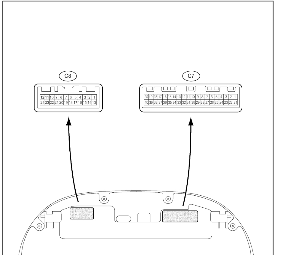

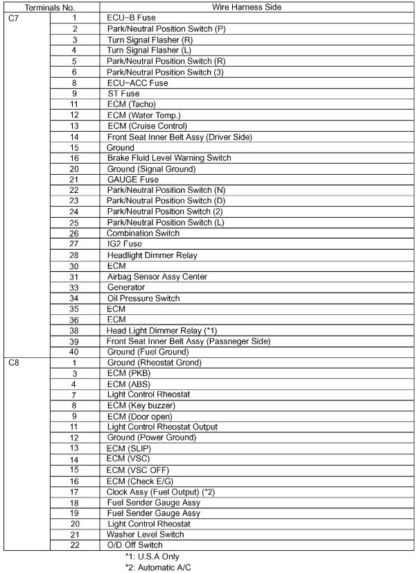

Yo Mick! How are things down under? The Aurion is a Camry so no worries there m8. Here is the pinout for the instrument cluster. Check out the images (below). Let us know if you need anything else.

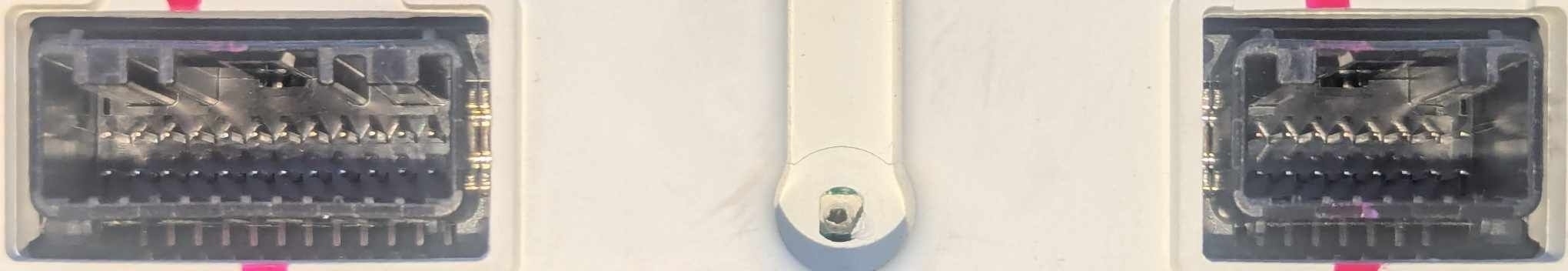

Thanks for your expedient reply. Unfortunately, that is not the cluster I have. The cluster I have has a 24-pin connector and a 16-pin connector.
I have attached a pic of the rear connectors.

Hmm, that is the only one they show, there must be a difference with the Aurion model. sorry m8.
