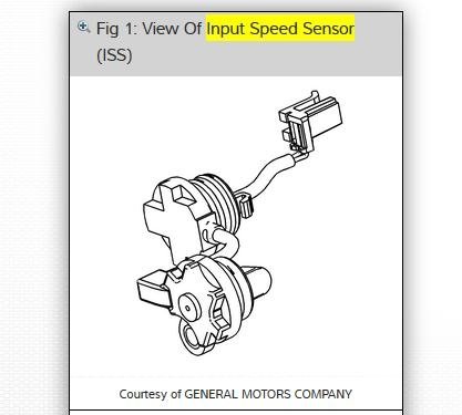

Location of input speed sensor can you tell me?
Jul 3, 2017 at 9:37 AM
MHPAUTOS
  • 31,937 POSTS
The input sensor for the transmission is near the front by the bell housing. Check out the diagrams (Below). Please let us know if you need anything else to get the problem fixed.

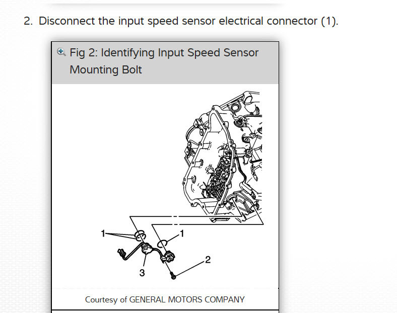

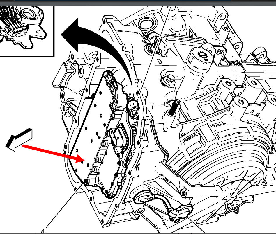

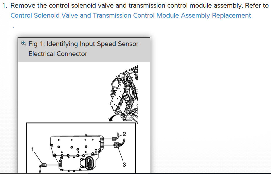

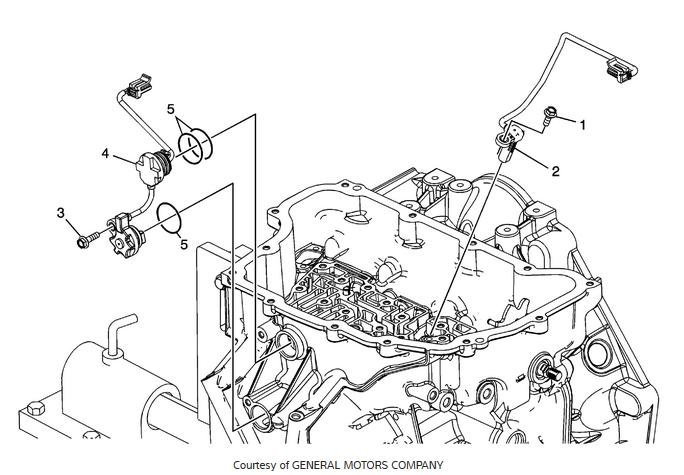

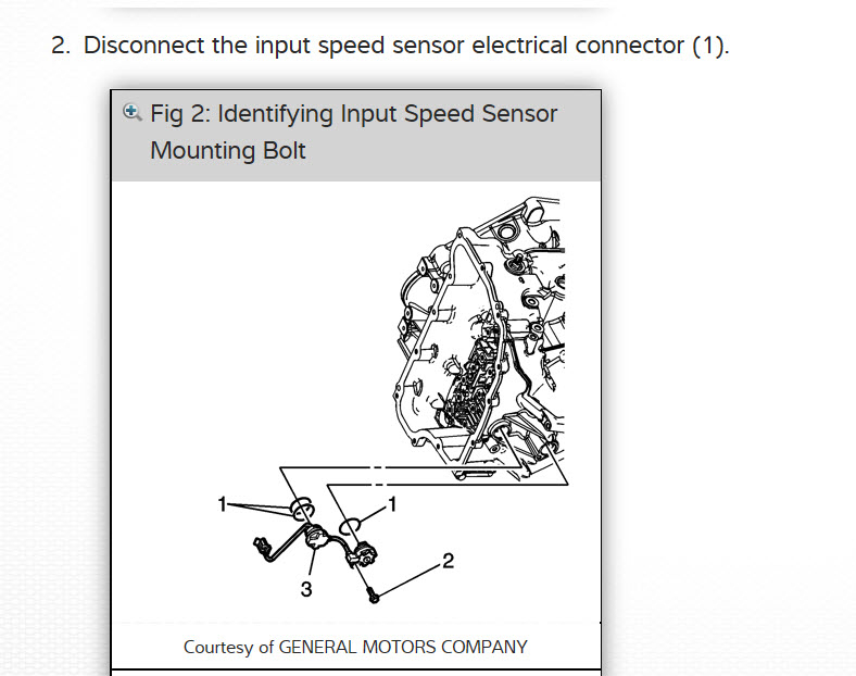

Where is it located, and how do I access it? I need to replace it. Picture would be great.
Feb 13, 2019 at 11:12 AM (Merged)
HMAC300
  • 48,601 POSTS

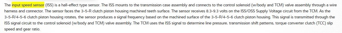

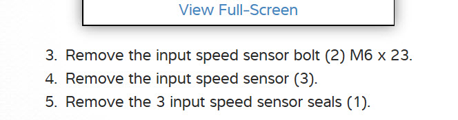

it is in the transmission see pictures for instructions if you want to tackle yourself.
67KAYLENE
  • 5 POSTS
So we are going to have to open the transmission up to get to it? Was really hoping it was reachable from the outside. Estimation of time it will take?
HMAC300
  • 48,601 POSTS
any estimate is for a mechanic that is familiar with it with little knowledge it can take you a half a day or more.

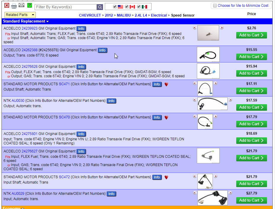

What is the part number for this sensor? I've been to auto zone twice now but the wrong sensors.
Jan 8, 2020 at 7:18 AM
The manual doesn't list the part number for it but I attached a link to a common parts website. This is for the input speed sensor so if this is wrong then I suspect we are looking for the wrong sensor.
https://www.rockauto.com/en/catalog/chevrolet,2012,malibu,2.4l+l4,1501855,electrical,speed+sensor,10634
