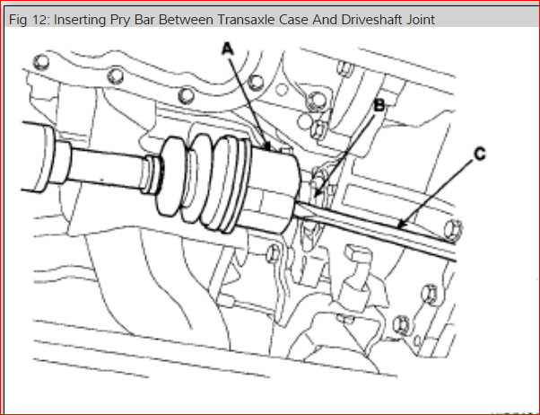

Having problems getting the inner bit of the passenger side front axle away from the transmission. I cannot seem to find a good place to put a bar. So I am going to keep gently beating the CV axle, or drinking beer. I will continue until I either figure it out, or someone has an easy way to get this thing free.

Hello, I am Danny.
I use a prybar for the extra leverage. It just might take some time/elbow grease. I have attached a picture for you about the prybar placement. Hope this helps and feel free to ask any other questions if needed. Thanks for using 2CarPros.
