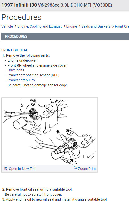

need procedure for front crankshaft seal replacement

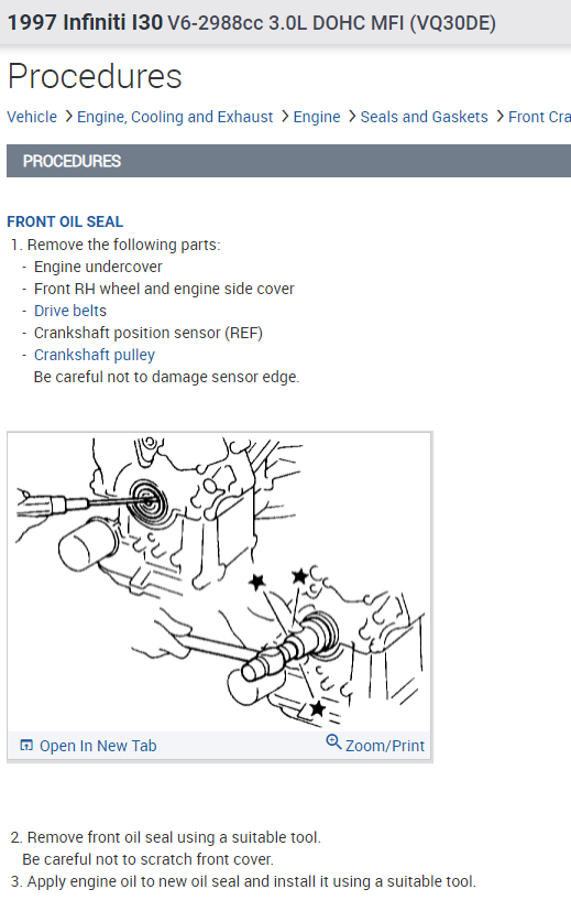

In order to replace the front crankshaft seal you will first have to remove the drive belt.
Then the crankshaft pulley needs to be removed.
That will give you access to the seal. Which can be removed using a seal remover tool.
You might find this article helpful:
https://www.2carpros.com/articles/front-main-seal-replacement
I have attached diagram for your reference.
