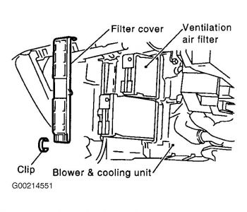

2001 Infiniti I30 6 cyl Front Wheel Drive Automatic
Where is the cabin air filter located and how do I gain access to it?

CABIN AIR FILTER Removal & Installation (2001) 1.Remove the glove box. 2.Remove the instrument lower panel from instrument panel. 3.Remove the filter cover fixed clip. 4.Slide the filter cover to the upper side and then remove it. 5.Take out the lower side ventilation air filter from cooling unit. 6.Then slide upper side filter to the bottom position and take off the ventilation air filter from the cooling unit. 7.Replace with new filter and reinstall on cooling unit. 8.Reinstall filter cover, clip, instrument lower panel and glove box. Courtesy of NISSAN MOTOR CO., LTD.
https://images.2carpros.com/forum/automotive_pictures/99387_i301_1.jpg
