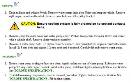

1996 Infiniti I30 waterpump
HELLOGOODBYE
MEMBER
1996 INFINITI I30
Engine Cooling problem
1996 Infiniti I30 6 cyl Front Wheel Drive Automatic
how to change?
Wednesday, January 21st, 2009 AT 10:27 PM
BLUELIGHTNIN6
MECHANIC
16,542 POSTS

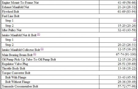

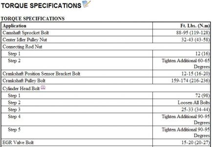

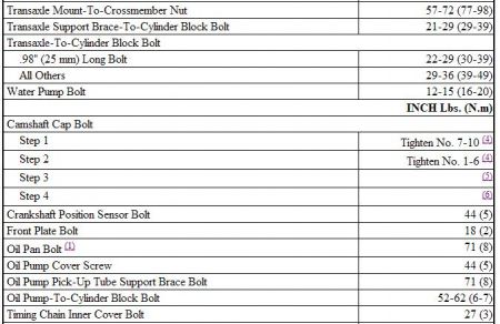

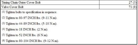

Instructions are below..
