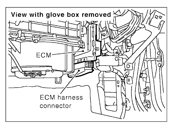

Where is the ECU located?
Monday, October 13th, 2008 AT 12:17 AM
MHPAUTOS
MECHANIC
31,937 POSTS
Hi there, according to the data base the ECU is behind the R/H/F kick panel or by the blower motor. Check out the diagrams (Below). Please let us know if you need anything else to get the problem fixed.
